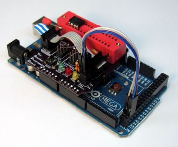

Arduino Mega:
This shield will work with the mega, but needs a 2x2 female header added in the lower right corner and four jumper wires to connect with Mega pins 50 - 53.

Setting the settings:
  1. The stock Arduino software comes with the "ArduinoISP" sketch in the "Examples" section. This sketch must be uploaded without the shield in place since the shield has a capacitor to over-ride the reset signal (or you could use a manual reset before upload, like in the old-old days).
  2. With the sketch uploaded, install the shield. You should see the green heart LED begin it's pulsing.
  3. In the IDE, select "Tools" -> "Programmer" -> "Arduino as ISP".
  4. Select the target chip type using "Tools" -> "Boards".
  5. Place the jumper cable between the "ISP" header and the correct header for the chip type.
Feel the burn:
Setting fuses is a scary and confusing topic if you look in to it much. Don't bother. They are basically setting that tell the chip how to behave and have to be done only once to a new chip.
  1. Place the chip in the ZIFF socket, all the way to the left, with Pin 1 in the lower-left corner.
  2. With the correct "board" selected for the target chip, select "Tools" -> "Burn Bootloader".
    1. For an Atmega chip going in to a UNO or breadboard, this will set the fuses and upload the correct bootloader.
    2. For an Attiny, this just sets the fuses. For us, this primarily concerns chip speed.
Upload a Sketch:
  1. Load the sketch for the target chip. Start with the basic blink "File" -> "Examples" -> "01.Basics" -> "Blink".
  2. Change the "led" variable from "13" to "3".
  3. Click the upload icon, or "File" -> "Upload".
  4. You should see the yellow LED flash and get an "Upload Complete" message.
  5. If all is well, the target chip should start blinking the yellow LED (attached to D3).
If all is well, pat your self on the back and start planning your next project. If not, move to the next step to do some trouble shooting.
