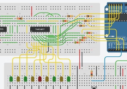

Step 2: Getting Familiar With the Circuit
This circuit fundamentally is a combination of two completely separate types of circuits that are united to work together through the Arduino Uno microcontroller. The pulsing and blinking action of the LEDs is completely independent of the Arduino as it is controlled by a completely analog circuit incorporating a 555 timer, and 4017 Decade Counter chipset. Everything else on the other hand such as the liquid crystal display responsible for notifying the critical information to the user, and the pushbutton are completely controlled through the code by the digital output/input pins on the Arduino. However, by attaching jumper wires to the 4017 Decade Counter chip located in the analog circuit, to the analog input pins and digital pins on the Arduino, I am able to successfully keep track of the LED which is currently blinking and then through the code am able to decode that information to tell the program as to which colored LED was caught when the button was pressed so the game can continue accordingly.
The circuit schematic included above should give one a good idea regarding the wiring of all the components within this project, while also providing insight into the inner workings of the circuit. Provided is also the Fritzing file of the schematic if you would like to open it up in the native software and take a closer look at it. However, if needed, you can also visit the my TinkerCAD page on this project to get a better and more real world look at the wiring and using it there by actually activating it and playing the fully functioning game.

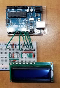

Step 4: Wiring the LCD
Now the Liquid Crystal Display (LCD), is one of the most important components within this circuit as it is responsible for conveying all the vital game related information to the user while the game is running. The LCD informs the user on what LED they caught, as since there is no other indicator, the LCD is the medium for letting the player know if they caught the red colored LED (objective of the game), a green colored LED, or a yellow colored LED. Without this the player won't even know if they are catching the correct LED or not. Furthermore, the LCD also displays the levels to the user, informing them about the current level they are playing which in turn informs them about their progress to beating the game. As I am sure you have understood by now, the LCD is fundamentally the communication medium between the game and player.
The wiring for the LCD panel follows as shown above and in the circuit schematic. You can also control the brightness of the display using the 'contrast' pin of the LCD (3 from the left). If you were to switch that ground wire with a potentiometer which has wires going to the ground and power rails, you can adjust exactly how bright you would like the LCD to be by twisting the knob on the potentiometer. For this project however, that was an unnecessary feature. Therefore I just fixed the brightness by plugging the contrast pin straight into ground using a black colored wire. If you would like to control the brightness of the LCD using the potentiometer, you can do so by following the circuit schematic shown in this insightful LCD Learners Page.

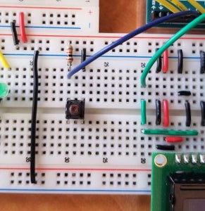

Step 5: Wiring the Push Button
Throughout the entire circuit, the wiring for the push button is the most straight forward and simple. The wiring for it can be seen in the pictures provided above and the circuit schematic, where you have a 1 kilo-Ohm resistor going from one leg of the button into the power rail, with a opposite leg going into ground using a black jumper wire. Then you would just attach a jumper wire going from the power rail which has the resistor to a digital pin ranging from D2 - D13 on the Arduino.
Now the button is really the only input device for the user. The user is to press the button when the red led flashes on in order to progress forward in the game. Linking the press of button with accordance with which LED is flashing is then later calculated using the code.

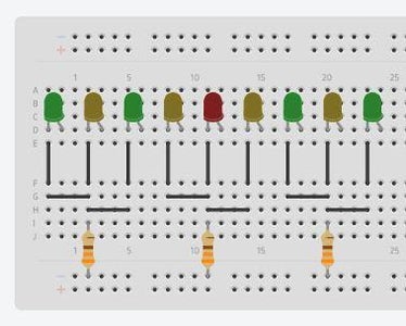

Step 6: Wiring the LEDs
The LEDs are really what the entire game revolves around, as the objective of the game is to press the push button when the red colored LED is flashing on to 'catch' the LED. The wiring for the LEDs is also rather simple as currently we are just going to be setting up the LEDs so we can wire the actual current connection to them later on. Since really only one of the LEDs will be flashing at a time and they all use the same size resistor, we could wire all the LEDs with one ground connection going through one 330 Ohm resistor. As you can see in the pictures above I was able to cut down the wiring and overall number of resistors I need to use to a maximum of 3 by having one resistor cover the ground connection for a total of 3 LEDs. However in theory you could cut yours down to only one. Just while wiring make sure to attach the cathode pin of the LED, which is the shorter leg to ground, as attaching the anode will result in the LED to not turn on.

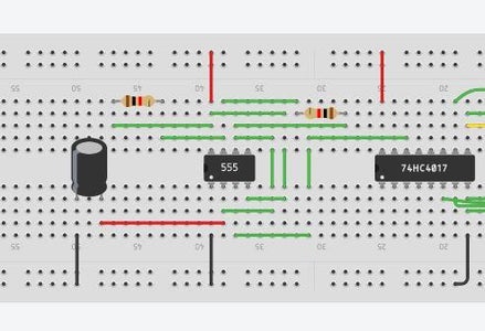

Step 7: Wiring the 555 Timer Chip
Now we begin construction of the analog circuit which controls the blinking and pulsing effect of the LEDs. The 555 timer chipset is the first step to creating this analog circuit. The 555 timer chipset is responsible for actually creating the pulsing electric current signal that flashes the LED on and then off. The 4017 decade counter which we will work with later is actually responsible for distributing the electric pulse current it receives from the 555 timer to each of the many LEDs to create that pulsing blinking action seen as they flash in order going from left to right, while the 555 timer chip actually creates that pulsing current to turn the LED on and then off. So the way the timer works is that power is fed through the chip and it outputs a HIGH current which is then fed to the 4017 decade counter that would then send that current to its appropriate output, being the LEDs in the set order going from left-right to blink them on. However, as the 555 timer is sending an HIGH electric current output to the 4017 decade counter, it is also feeding the same current to the 100μF capacitor, thus charging it up. The HIGH electric current output from the timer is maintained as long as the capacitor isn't fully charged up, however once the capacitor fully charges up, it releases that current to the timer which would then force the timer to output a LOW current, which once the LED receives turns it off. Then that LOW electric current is maintained as long as that capacitor is discharging, once fully empty it will begin to charge up again thus allowing for the 555 timer to send out a HIGH electric current instead of a LOW, therefore turning the LED back on. By this pulsing action of a HIGH and then a LOW current, it forces the LED to constantly switch between being off and then back on, thus creating the actual blinking action seen on the LEDs. Then the time that it takes for the capacitor to charge up and then discharge creates this type of analog timer between the pulses of the HIGH and LOW electric currents, thus setting the time for how long the LED stays on, giving the user the chance to press the button to catch the light.
The overall wiring of the 555 timer can be seen in the pictures above and the circuit schematic, you can just follow that to wire your own timer. Just as a side note, changing the capacitor size will effect the duration of how long your LED light stays on for, thereby greatly impacting the overall speed of the pulsing action and in turn the difficulty of the game. You can experiment with the size of the capacitor, making it greater or smaller to make your game easier or harder.
Step 8: Wiring 4017 Decade Counter Chip
Fundamentally, the objective of the 4017 decade counter chip is to distribute the HIGH level electric current it receives from the 555 timer in chronological order to the LEDs going from left to right to create that iconic pulsing effect. The 4017 chip has a total of 10 output pins, each labeled in ascending order. Through the input pin located on the decade counter, we are able to feed the chip the HIGH level electric current pulse from the 555 timer. The chip would then take that pulse and send it to the first output pin, thus letting the current pass through to the first LED in the line of LEDs thus turning it on. Then, when the 555 timer sends the LOW level electric current pulse, the decade counter chip would then send that LOW level current as well to the first LED, thereby turning it off. However, once it turns the first LED off, the chip essentially switches output pins, then when the next pulse of a HIGH electric current arrives, the chip would then send that HIGH level current to the second pin, thus turning on the second LED in the line of LEDs. Then once the LOW level electric current comes from the 555 timer once more, the decade counter would send that LOW level electric current to the second LED thus turning it, after which, it would switch output pins so that the next HIGH level current is passed through to the third output pin to turn the third LED on. By constantly rotating the pins that receive the HIGH level electric current during the time when a LOW level electric in ascending order, the LEDs are flashed on and then off in the pulsing action we require.
Since the LEDs are powered by this analog circuit and not digitally by the Arduino, it is much more difficult to monitor and keep track of the LED currently being turned on. Without keeping track of the LED currently being lit up, we can not find out if the player was able to catch the red LED when the button is pressed. Therefore, to monitor which LED is currently getting power and is flashing on, we have attached jumper wires into the output pins of the 4017 decade counter, that feed the same HIGH electric current being sent to the LEDs to turn them on to the analog input pins and the digital pins set for input on the Arduino. This way by monitoring which output pin is currently sending a HIGH level electric current pulse to the LED thus turning it on, we can know which LED is flashing at all times and could know which LED was flashing when the button was pressed, thereby the game is able to determine if the red LED was caught or not by the player.
The wiring for the decade counter can be found above in the pictures and in the circuit schematic. You can follow that to successfully wire the 4017 decade counter for your circuit.
