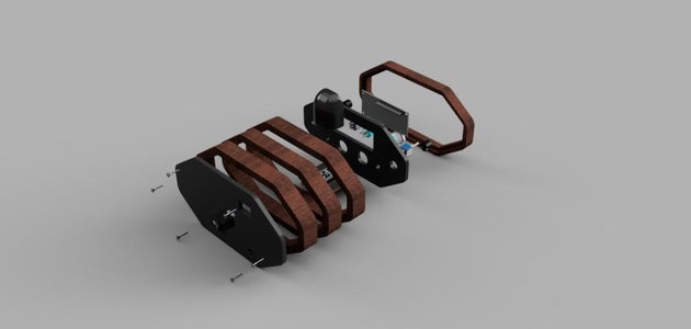

I chose to laser cut both the user interface and the back piece of the product using matte black acrylic. I was able to also use the laser cutter to engrave labels for the different switches and then using a paint marker to color them. Attached to this instructable is a full CAD drawing of the entire product and the measurements can be found there. I used 3mm acrylic and for this reason the groove in my first wood piece was 3mm deep, you can change that depending on what type of acrylic you are using.
I also 3D printed the housing for the watch charger using Black PLA. The design can be found in the attached CAD file.

I then installed all the switches into the user interface, fitted the interface into the groove of the first wood piece, and glued that to the main body. While it was drying I mounted the rest of the circuit onto some balsa pieces inside the wood body. Finally, I used m4 wood screws to connect the back acrylic piece to the wood body and countersunk the holes so that the screws were level.
