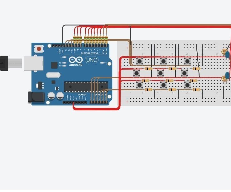

The components used in this alarm system are fairly basic and easy to wire. The first few components to wire are the breadboard are the 7 Segment Display, RGB LED and Buzzer. The 7 Segment display will take the most digital I/O pins from 12- 6. It will require 7 connections but also require 2 connections to power. The RGB LED will also connect to digital pins 5-3. If you have a common anode LED, it will connect to power and a common cathode will connect to the ground. The first connection will be the red, the second will be power/ground, the third will be green and the fourth will be blue. The buzzer also has a simple connection with a digital I/O and ground, with the digital pin going to the side with the + sign.

The IR Receiver is one of the main parts of the project. The IR Reciever will take in signals from remotes and we can use this in our code. It is wired with a connection to a digital I/O pin, power and ground. Once you connect the IR Receiver you can use this code to help decide which buttons on a remote you want to use. Once you upload this code to your Arduino, open up the serial monitor and press a button on the remote. Each button will have a different number and value assigned to it. Looking at the serial monitor, you can decide which button you want to use and keep the assigned value of the button aside for the alarm system code.

Now we are going to add the final 2 components to the project. The PIR sensor and distance sensor. These sensors are responsible for making the buzzer as they detect if the box door opens or if there is any movement within the box. The PIR sensor is connected through power, ground, and an I/O pin. You can use one of the analog pins as the connection instead of a digital pin if the previous components took up all digital I/O pins from 2-13. The distance sensor will need a connection to power, ground and two I/O pins (digital or analog). Once the sensors are added, we move on to the code.

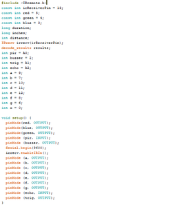

Step 4: Code (Defining Variables)
The first thing we have to do in the code is declare all the variables and pinModes. The echo pin and pir sensor pin will be the only inputs, with all other components acting as outputs. We also have to attach the library as we are using an IR Receiver.

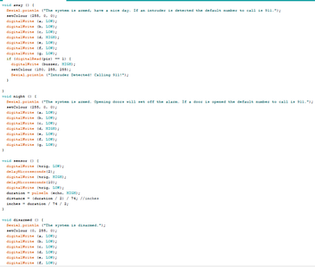

Step 5: Void Functions

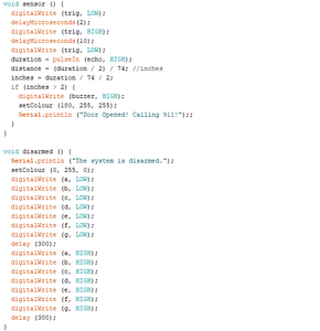

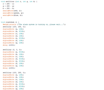

The next part of the code is defining different functions. The setColour code is for the RGB LED and is an easy way to code which colour the RGB LED will output by having different values of red, blue and green. The countdown function is used for the alarm system countdown after arming it. It counts down from 5 to 0 while also making the led flash yellow. The away function is how the circuit should react after a button is pressed and gets the pir and distance sensor ready. Void night acts the same as void away, but for the night mode, which only uses the distance sensor. Void sensor is what the distance sensor should do when the system has been armed. Void disarmed is what the system should do once it is disarmed. Disarming the system will turn off the buzzer and the other two sensors. The error function is used if the wrong button is used to try and start the alarm system. The final function is off, which powers down the entire system.
Step 6: If Statements (Button Presses)

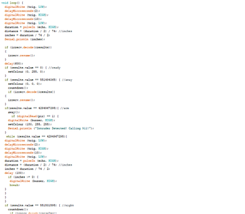

The first if statement in the void loop is what gets the IR Receiver to receive input from a remote. The if statements that come after it say that if one of the buttons is pressed, the corresponding functions will happen. For example when the night button is pressed, the functions sensor, countdown and night will happen. After understanding what the functions do, the void loop code is a lot easier to understand.
Step 7: Full Code
Here is the file code file (Note: Depending on how you wired the circuit and what you want the circuit to do when pressing a button the code will need to be modified).
