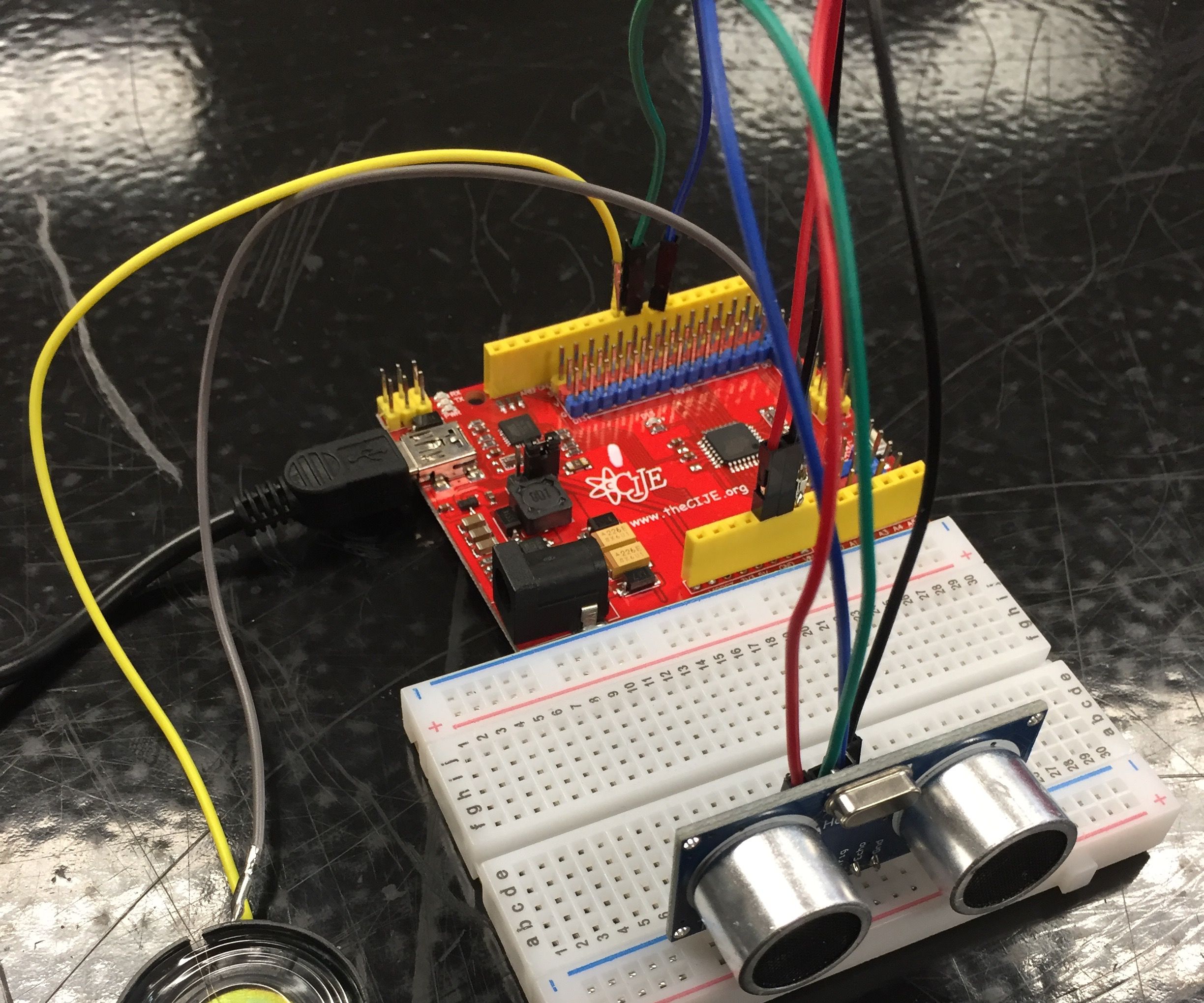

In this project you will build an alarm that goes off when someone walks by. You can also arm and disarm the alarm using your iOS iPhone. This project can be helpful to you whether you really want to set up an alarm or if you simply want to brush up on your coding skills. Either way, I hope you find this interesting and please leave feedback if you liked it.
Step 1: Materials
For this project you will need:
1) An Arduino,
2) A breadboard
3) A few wires
4) An hc-sr04 ultrasonic sensor,
5) A piezo speaker.
6) HM-10 bluetooth micro-controller
Step 2: Assemble the Alarm
First: For the ultrasonic sensor, using wires, put ground into ground, Echo into D7, Trig into D8, and Vcc into 5v.
How it works- It emits an ultrasound at 40 000 Hz which travels through the air and if there is an object or obstacle on its path It will bounce back to the module. Considering the travel time and the speed of the sound you can calculate the distance. In order to generate the ultrasound you need to set the Trig on a High State for 10 µs. That will send out an 8 cycle sonic burst which will travel at the speed sound and it will be received in the Echo pin. The Echo pin will output the time in microseconds the sound wave traveled. For example, if the object is 10 cm away from the sensor, and the speed of the sound is 340 m/s or 0.034 cm/µs the sound wave will need to travel about 294 u seconds. But what you will get from the Echo pin will be double that number because the sound wave needs to travel forward and bounce backward. So in order to get the distance in cm we need to multiply the received travel time value from the echo pin by 0.034 and divide it by 2.
Second: Connect the bluetooth module to the Arduino. Vcc to 5v, GND to ground, TXD to D10, RXD to D11.
Download the app Blynk to your iPhone. For more information go to http://www.blynk.cc
Third: connect the speaker to the Arduino. Connect one pin to D9 and one to GND.
