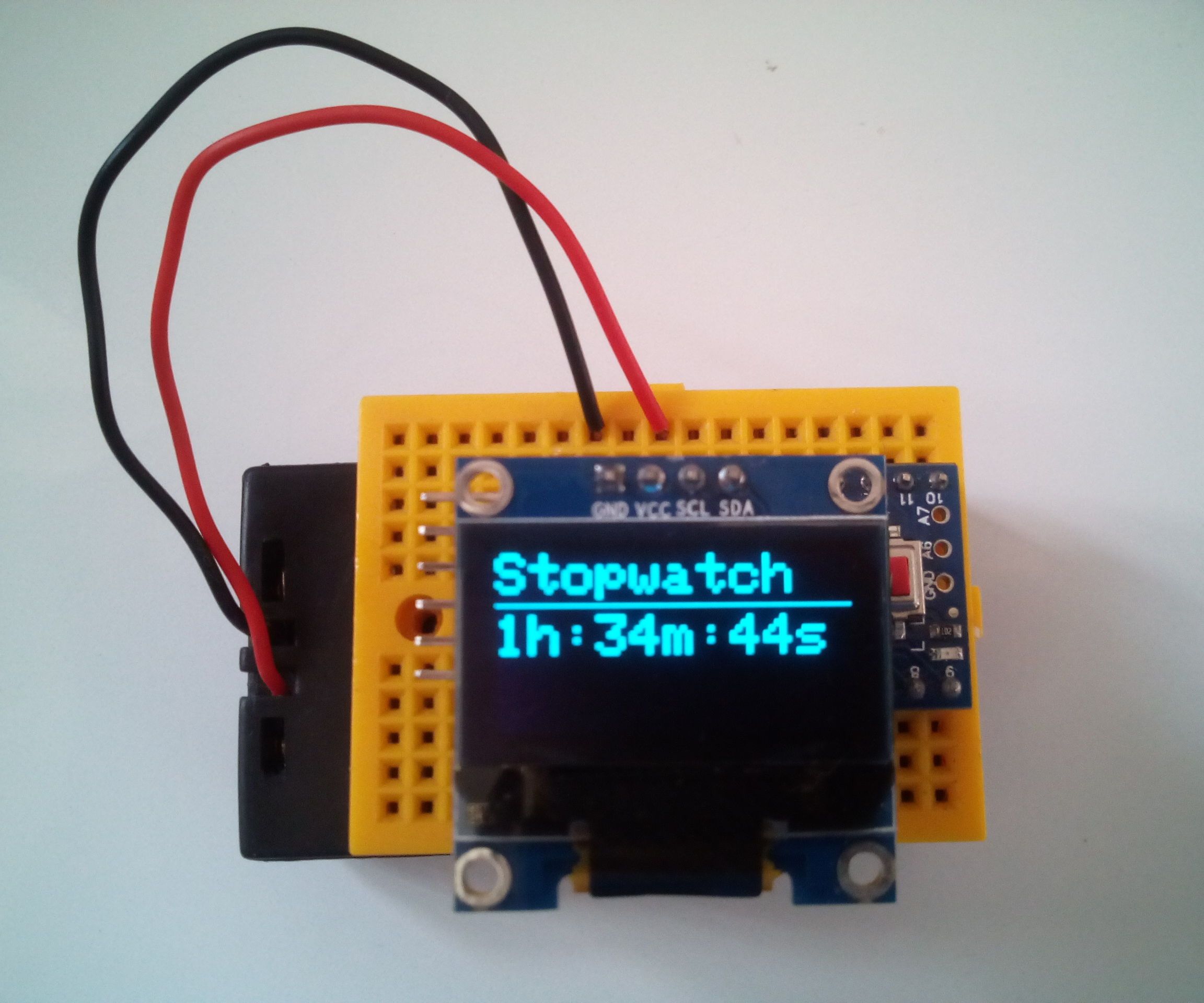

Connecting The OLED: (Refer to images above for colors)
- Red Wire (VCC):5v of the Arduino
- Green Wire (GND):Ground of the Arduino
- Purple Wire (SCL):SCL of the Arduino (Check bottom of board for labeling, if no specific SCL pin, it's usually A5)
- Orange Wire (SDA):SDA of the Arduino (Check bottom of board for labeling, if no specific SDA pin, it's usually A4)
Connecting The Sensor: (Refer to images above for colors)
- Power the sensor according to its specific pinout
- The output of the sensor should go to A0
