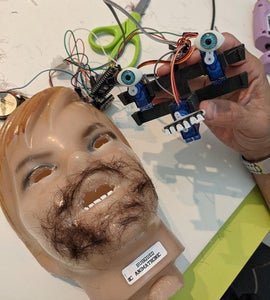

This simple, and sort of kitsch animatronic head was made with parts found on the trash and was intended as a recursive tribute (to a deceased talented local writer with admiration for Phil K. Dick and interest in the animatronic head incident)
  • Arduino Nano
  • 3 SG90 Servos
  • DfPlayer mini
  • microSD card
  • 4ohm 3 watts speaker

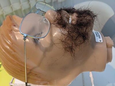

  • Mannequin head and doll eyes
Step 1: Head Setup
Using a Dremmel or a saw cut the head in 2. Then cut holes in eyes and mouth.

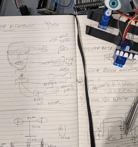

Step 2: Circuits and Audio
  • Connect SG90 servos to 5V external power jack and D9, D8, D7
  • Connect DfPlayer mini to 5V external power, to Speaker and D10/D11. Connect also Busy pin to D6. This pin will be used to determine when mp3 audio reproduction ends
Regarding audios. Record your animatronic voices using 001.mp3 002.mp3, etc and place all those files into microSD, inside a /01 folder placed in root.
Step 3: 3d Printed Skeleton and Mouth
  • Download 3d parts from https://www.thingiverse.com/thing:4833147
  • Print them with PLA
  • Put eyes servo and mouth servo into the skeleton
  • Paint teeth white
  • Glue upper teeth row into the head
  • Glue down teeth row into a servo arm

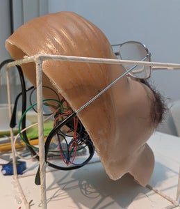

  • Place the skeleton in the head. You can use screws or glue
