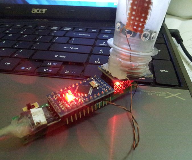

- An Arduino Uno R3.
- An PIR sensor (Passive InfraRed sensor).
- A speaker (You use a small one).
- A LED light.
- A laptop to program the Arduino.
Step 2: Wire Connection
You connect like this:
- Connect GND pin of the sensor with GND pin of the Arduino.
- Connect VCC pin of the sensor with 5V pin of the Arduino.
- Connect OUT pin of the sensor with pin number 2 of the Arduino.
