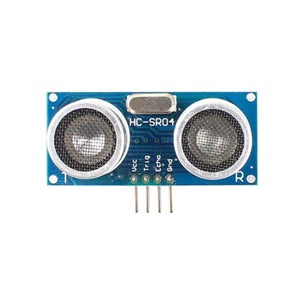

Step 1: Sensor for Detecting Distance????
There are many many variants of sensors to detect distance. These variants differ in terms of sensor size, sensor distance range, sensor pinouts and sensor accuracy. For this project, we are going to use a quite common sensor for Arduino users.
We are going to use the HC-SR04 Ultrasonic Distance Sensor(as the image shown)
From the sensor we have 4 pin outs: Namely:
VCC- Power pin, connect the pin to a 5V
GND- Ground pin, Connect to a ground
Trig-This pin functions as to send a trigger pulse for distance detection
Echo- This pin sends another pulse to detect the if there is an object in the distance. If a pulse is returned, then there is an object and vice versa
How to connect to Arduino? Here you go!
VCC->5V
GND-> Ground pin
Trig->pin 7 digital pin
Echo-> pin 8 digital pin
