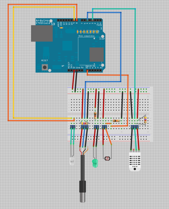

Figure 3 shows the Fritzing diagram to connect the ChronoDot to the Arduino. Mounting to a perf board or breadboard is straightforward with the RTC's male header pins.
