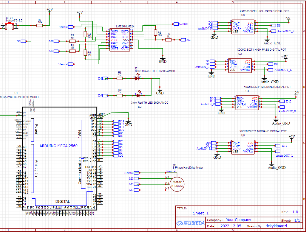

Step 1: Connecting the Circuit
The circuit diagram was designed on EayEDA as shown. The rotary encoder has incremental movement and the direction, position can be determined. Basically the encoder has a disk with evenly spaced contact zones that are connected to the common pin/ connection and two other separate pins. When the disk starts rotating step by step, the two pins will start making contact with the common pin and the two square wave output signals will be generated accordingly. Any of the two pin outputs can be used for determining the rotated position if the pulses of the signal are counted. However, if the rotation direction is to be determined, both signals have to be considered at the same time.
The push buttons are connected to pullup resistors. As seen from the circuit diagram some of the analogue pins were used as digital pins which works okay as normal digital pins.
Digital Potentiometer, the X9C103 was used, it works as a normal potentiometer but in this case the arduino pro mini with the help of the rotary encoder controls it.
