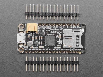

The Feather M0 Adalogger (Adafruit Product ID: 2796) is an 'all-in-one' Cortex M0 data logger (or data reader) with built-in USB connector and LiPo battery charger. It's an Adafruit Feather M0 with a microSD holder. The heart of the Feather M0 is an ATSAMD21G18 ARM Cortex M0 processor clocked at 48 MHz and with 3.3V logic, the same one used in the Arduino Zero/M0.
It has an I2S bus and an SD card holder with its own SPI interface with which you can play audio files. I2S (not to be confused with I2C) is a digital audio protocol used to exchange audio data between chips. The Arduino Sound Library is available to play and analyze audio data.
Adalogger supports microSD cards up to 32GB.

Step 1: Add Feather to Carrier Board
You can use the included header connectors to solder on the Feather module and plug it into the carrier board.

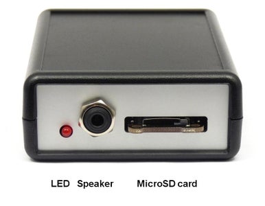

You can connect a speaker by using a 3.5mm mono audio plug. Or use a speaker with plug, like this one from Monacor.

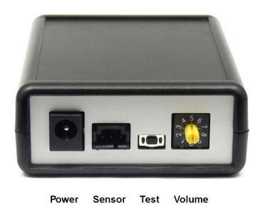

The sensor input is a 3-pin female AMPMODU MTE connector. Pin 2 is connected to D6 of Adalogger and has 10K to GND. Pin 3 is connected to 3V3. If your sensor has a switch as output, it can be connected to pin 2 and 3. To connect a sensor to this input, you can use for example cable assembly 1-2267795-2 from TE Connectivity.
To power the audio player 9 Vdc to 24 Vdc can be used with 1 A max. A standard power supply with a 5.5x2.1mm, center-positive barrel jack can be used. The power input is protected against reverse voltage and has a current limiting fuse.

Step 8: Enclosure
The Audio Player fits inside a Hammond 1593L enclosure. Front and back panel design are available as PDF and DXF.
