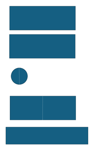

To construct the case, I will use cardboard. The PDF file containing the cardboard cutout templates is attached below. Please refer to the accompanying images for guidance on assembling the case for this project.
