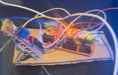

Connecting the Arduino to the Sound Sensor:
  1. Connect the A0 pin on the sound sensor to the A0 pin on the Arduino.
  2. Connect the GND pin on the sound sensor to any GND pin on the Arduino.
  3. Connect the 5V pin on the sound sensor to the 5V pin on the Arduino.
Connecting the LED Strip to the Arduino:
  1. Attach the LED strip's DIN (Data In) pin to a resistor (optional), then connect it to Digital Pin 5 on the Arduino.
  2. Connect the 5V pin of the LED strip to either the 5V pin on the Arduino or an external power source.
  3. Connect the GND pin of the LED strip to either the GND pin on the Arduino or the ground of the external power source.

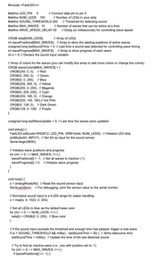

Code Explanation of loop():
1. Read Sound Input
  1. The code reads sound intensity from the sensor connected to analog pin A0:
  2. s = analogRead(A0);
  3. The sound value (s) is used to determine if a new wave should be triggered.
2. Check Sound Threshold
  1. A new wave is triggered if the sound value exceeds the threshold (SOUND_THRESHOLD = 200) and at least 100ms has passed since the last wave:
  2. if (s > SOUND_THRESHOLD && millis() - lastSoundTime > 100) {
  3. createNewWave();
  4. lastSoundTime = millis();
  5. }

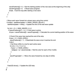

3. Update Wave Animation
  1. The animation of active waves is updated periodically based on the WAVE_SPEED_DELAY (50ms):
  2. if (millis() - lastWaveUpdate > WAVE_SPEED_DELAY) {
  3. updateWaves();
  4. lastWaveUpdate = millis();
  5. }
4. Refresh LED Display
  1. The LED strip is refreshed to display the updated wave patterns:
  2. FastLED.show();
Helper Functions:
createNewWave()
  1. Activates a new wave if there’s an available slot:
  2. Finds the first inactive slot in the wavePositions array.
  3. Assigns a random starting position and a color from the waveColors[] array.
updateWaves()
  1. Moves active waves along the LED strip:
  2. Increments each wave’s position stored in the waveProgress[] array.
  3. Deactivates waves that move past the LED strip boundary.
