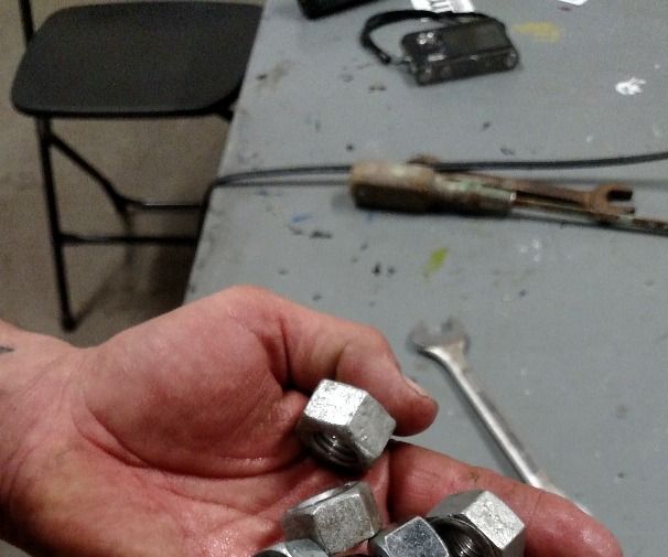

Step 6: Alternative Moisture Sensor Option
This was the other option I played with for a sensor. It is very basic and can be made with found parts. It is two screws, something to hold them a distance apart and wire. This is prone to quicker moisture changes in the soil, but in some cases it was more ideal. Keep in mind when soldering to nails and screws higher heat may be needed to compensate for the dissipation of heat and also be mindful of the types of metal you are soldering to.
