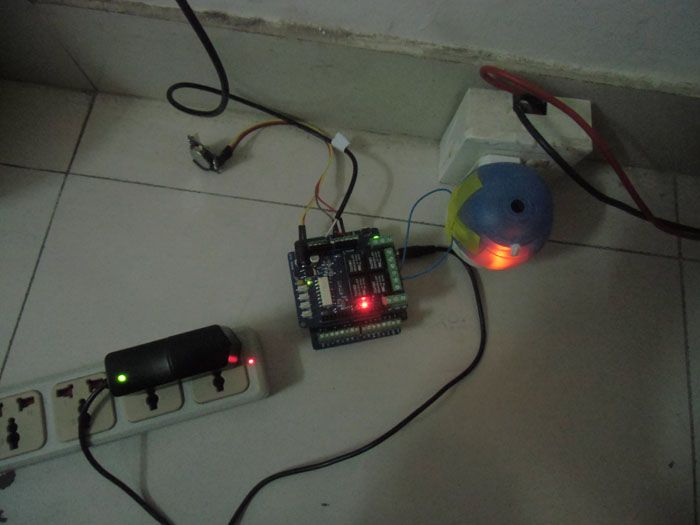

Step 2: Temperature& Humidity Measurement
The Basic Connection of all the modules(Crowduino, temperature sensor, relay module…) as above image.
First, connect the temperature& humidity sensor AM2302 to Crowduino board. Using the wire jumper, connect the AM2302 power supply pins to Corwduino VCC and GND, connect the “SIG” pin of AM2302 to A1 of Crowduino.
Note that a 4.7K pull up resistor is needed between “SIG” of AM230 and VCC. Actually, you can also find many temperature and humidity module that had integrated the pull up resistor on the module, so you do not need to add the pull up resistor by yourself and thus the story would be easier .
Step 3: Connect the Relay to Crowduino, to Control the Ultrasonic Nebulizer and Thermal Tablets.
Connect the “IIN1”and “IN2” of the 2-channel relay module to A4 and A5 pin of Crowduino (or Screw Shied), power the relay module using jumper wires. In this way, Crowduino can control the 2 relays separately to power on/off the ultrasonic nebulizer and thermal tablets.
At last, connect the ultrasonic nebulizer and thermal tablets to relays. For the ultrasonic nebulizer, I cut off it is positive wire, and connect its one end to the relay1 “COM” port (the port in the middle), connect the other end to relay1”NO” terminal. For the thermal tablets, it would easier, solder its terminals to DC jack and connect to relay2 with the same way of ultrasonic nebulizer
After the connecting, the basic hardware for hamster new house completed.

While system is running, the current temperature& humidity can be monitored via the LCD Keypad Shield.
Insert the thermal tablet at the bottom of the hamster house, i also added some wood flour as they keep the house warm like quilt. The thermal tablet will be active when the temperature below 9 degree and can be up to about 40 degrees; Put the ultrasonic nebulizer in water with depth of about 0.3 meters, it will be active when the relative humidity below 45%.
After testing, the system works perfect, the thermal tablet begin to warm up when the temperature is low, and the ultrasonic nebulizer begin to work, with beautiful blinking LED. With this system, I believe my hamster would be happy when I keep pet next time.
