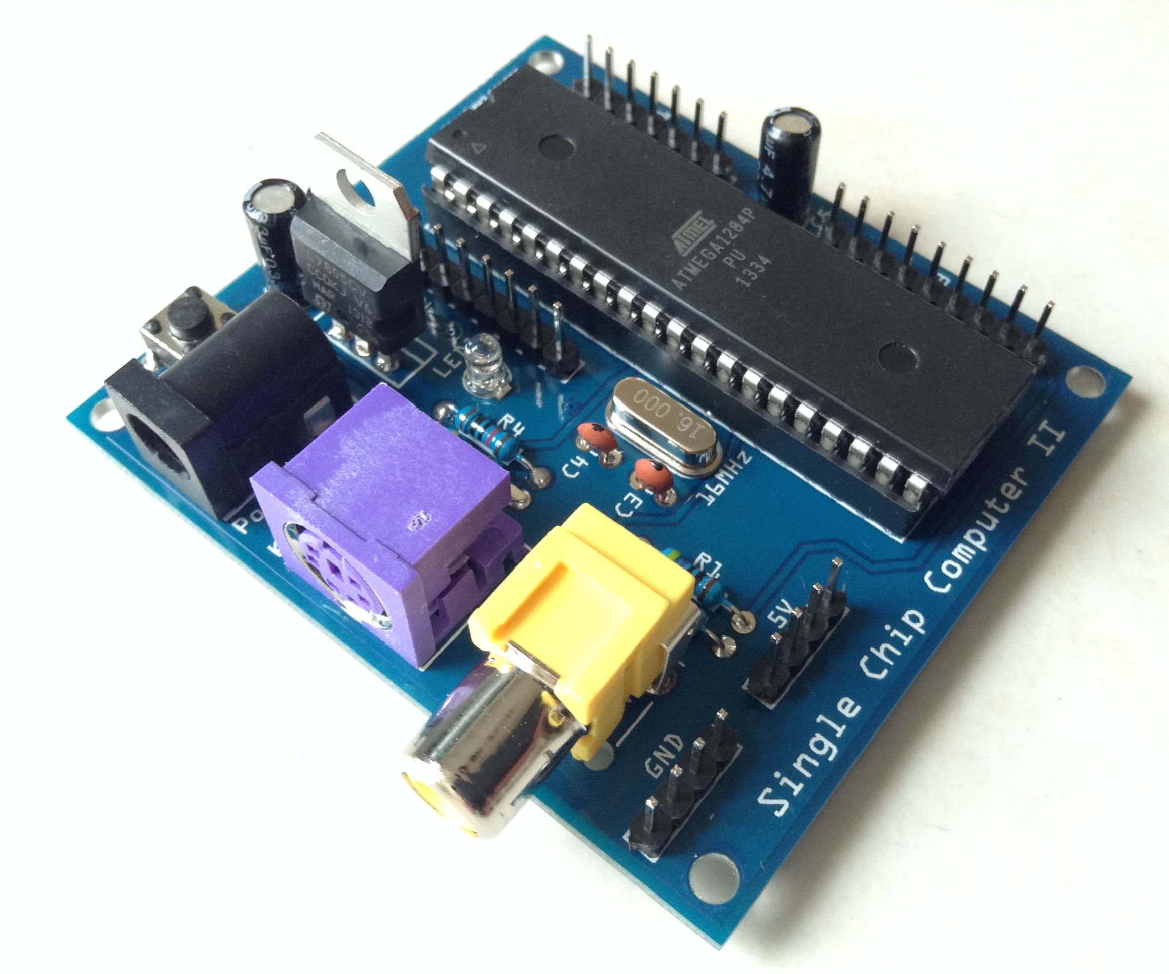

Step 2: The Circuit
The circuit diagram (and the PCB) were created in the program Fritzing. The circuit diagram is not very complex and consists mainly of the 1284P, PS/2 socket, RCA socket, an LED, some pin headers and some resistors.
The Arduino UNO is responsible for generating a video signal and prints characters received from the serial port to the TV while the 1284P runs TinyBASIC and reads the PS/2 keyboard input. Any input from the keyboard or output from TinyBASIC is sent serially to the Arduino UNO and printed on the connected TV.
After looking at the PS/2 library, the file called "PSKeyboard.h" shows the known interrupt pins of supported AVR microcontrollers (AVR microcontrollers which can run the Arduino bootloader and support this library). An interrupt pin must be used for the keyboard clock line meaning pins 2, 10 and 11 can be used as the clock pin on the 1284P; I chose to use pins 10 and 11 for the data and clock lines of the keyboard.
The TVout library uses pin 7 for video and pin 9 for sync on the Arduino UNO so the RCA socket was connected to the appropriate pin headers. An LED was also included onboard to indicate if the shield was being powered.
TinyBASIC supports the IO pins of the 1284P so these were broken out using female pin headers. Port A (PA0-PA7), port B (PB0-PB7) and port C (PC0-PC7) are connected to female headers to allow the shield to be connected to other devices or components such as LEDs. Two other headers are onboard to allow connections to the power pins (5V and GND) and to allow the serial communication between the 1284P and the UNO to be connected to.
The image shows the circuit diagram with an ATmega 644 (the 1284P and 644 are pin compatible) and the Fritzing project file and circuit diagram PDF can be found attached (as a RAR archive).

Step 3: The PCB
Once the PCB had been designed in the Fritzing program, it was sent to a PCB manufacture to be produced using the isolation milling process. I designed the PCB to be double sided to reduce the number of jumper parts needed and to make the PCB designing process simpler (it would be harder to keep the PCB single sided due to its small size). Also, through hole plating would be needed to keep the PCB single sided as the pin headers need to be soldered on the top side.
As the PCB production process does not have through hole plating, I had to use vias to jump between layers. A small piece of tinned copper wire is placed in the via hole and soldered on either side to make a connection between the top and the bottom layers.
To reduce the number of components in the circuit, no crystal was used as the 1284Ps clock source, instead its internal 8MHz oscillator is used.
One of the images shows a copper coloured PCB. This is a manufacturing reject board as the PCB manufacturers milling machine did not produce this board correctly (the holes are slightly out). The reason this board is copper coloured is because it is not tinned. The tinned PCB was correctly produced and used to create the shield.

Step 5: Completed Shield
Once the PCB had been designed and manufactured, it was soldered and tested. One issue which arose was serial communications from the 1284P were not being received by the Arduino UNO. To find the cause of this issue, a multimeter was used and a short was found between the TX pin of the 1284P (the RX pin of the Arduino UNO) and ground. Once the short was fixed, the shield operated correctly.
When connecting a TV and a PS/2 keyboard to the shield (as well as a power supply connection), I was met with the TinyBASIC start-up messages which indicate the amount of memory available and the software version showing everything was working OK. The images show the setup with TinyBASIC being displayed on the connected TV and the fully assembled PCB.
