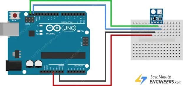

Step 2: Wiring BMP180 Module to Arduino
Let’s establish the connection between the BMP180 module and the Arduino.
The connections are straightforward. Begin by linking the VIN pin to the 5V output on the Arduino, and connect GND to ground.
Next, focus on the pins designated for I2C communication. It’s important to note that each Arduino Board features different I2C pins, so make sure to connect them accordingly. On Arduino boards with the R3 layout, the SDA (data line) and SCL (clock line) pins are located on the pin headers near the AREF pin. They are also identified as A5 (SCL) and A4 (SDA).
For the Mega, the pin configuration is different. You’ll need to use digital pin 21 for SCL and pin 20 for SDA. Refer to the table below for a quick reference:
