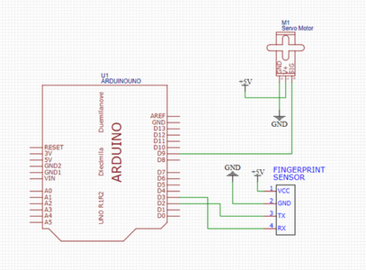

Step 1: Connections
Follow the diagram above for the Connections. You can cut the blue and green wires of the fingerprint sensor as they are not needed. I have also done the connections as per the diagram.
