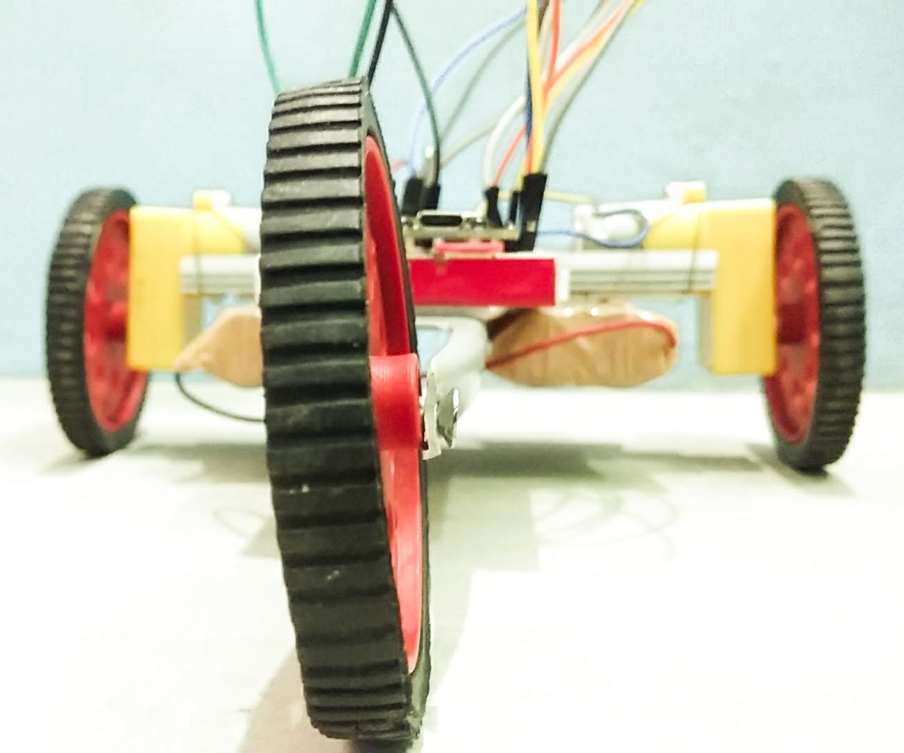

Step 2: Creating the Body of the Bot
Follow the following step for making the body of the bot :
Step 1 : Solder the female header pins on a small piece of PCB as shown in the photo. And attach a screw to it.
Step 2 : Now screw that PCB to your servo motor and make sure it is tight enough.
Step 3 : Take your ultrasonic sensor and put it's male header pins into the female header pins on the PCB. Insert it properly ( to ensure the connection ). And align it in such a way so that the 90 degree of the servo motor should face the front side of the bot.
Step 4 : Now for making the body of the bot you can use cardboard or plastic board wtih some hot glue or screws. I made the body of the bot with some wiremold laying around and screws.
Step 5 : Place the Arduino and the breadboard on it's position as shown in the photo and secured it with some hot glue or double sided tape.
Step 6 : Finally place the servo motor on it's position and fix it with whatever you want.
