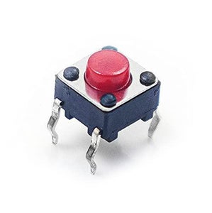

Push Buttons
Push buttons are basic electronic components used for user input in circuits. When pressed, they physically connect two electrical contacts inside the button, allowing current to flow. In microcontroller projects, push buttons are commonly connected to digital input pins. The microcontroller can detect the change in the pin's state when the button is pressed or released, enabling it to respond accordingly, such as triggering an action or changing a setting. Due to their simplicity and reliability, push buttons are widely used for tasks like menu navigation, mode selection, and user interaction in electronic projects.
