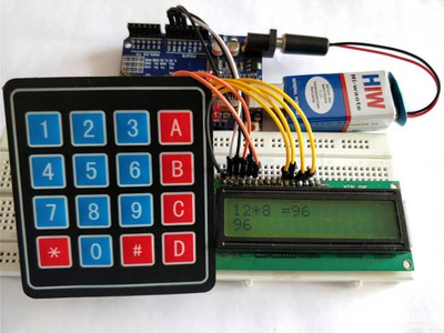

A simple Arduino based calculator can be easily implemented using Arduino development board, LCD and keyboard to solve mathematical calculations using keyboard and LCD. Simple mathematical calculations such as addition, subtraction, multiplication and division can be easily done using this project.
1602 LCD is able to solve mathematical calculations within 16 bits without delay and fast processing. The Arduino program is also very simple, almost like a simple C program, based only on simple formulas of addition, subtraction, multiplication and division. So, let's implement this simple little project.

Step 1: Circuit Diagram
The circuit diagram is very simple. You can assemble the circuit directly on the Arduino development board or by making a PCB.
Step 2: Source Code
The program is based on the Arduino UNO development board and is completed using the Arduino language. You need to add an additional Arduino library file for the keyboard, such as #include <Keypad.h>. Therefore, download this file from the adafruit library. After assembly, just upload the source code to the Arduino Uno development board and you can enjoy the Arduino-based calculator.

Step 4: Work It Out Finally
Make the connections as per the circuit diagram and upload the code below. If it shows an error, make sure that you have added the library as per the instructions given above. You can also try simulation to check if the issue is with your hardware. If everything is done as expected, then your hardware will look like this with the LCD showing this
