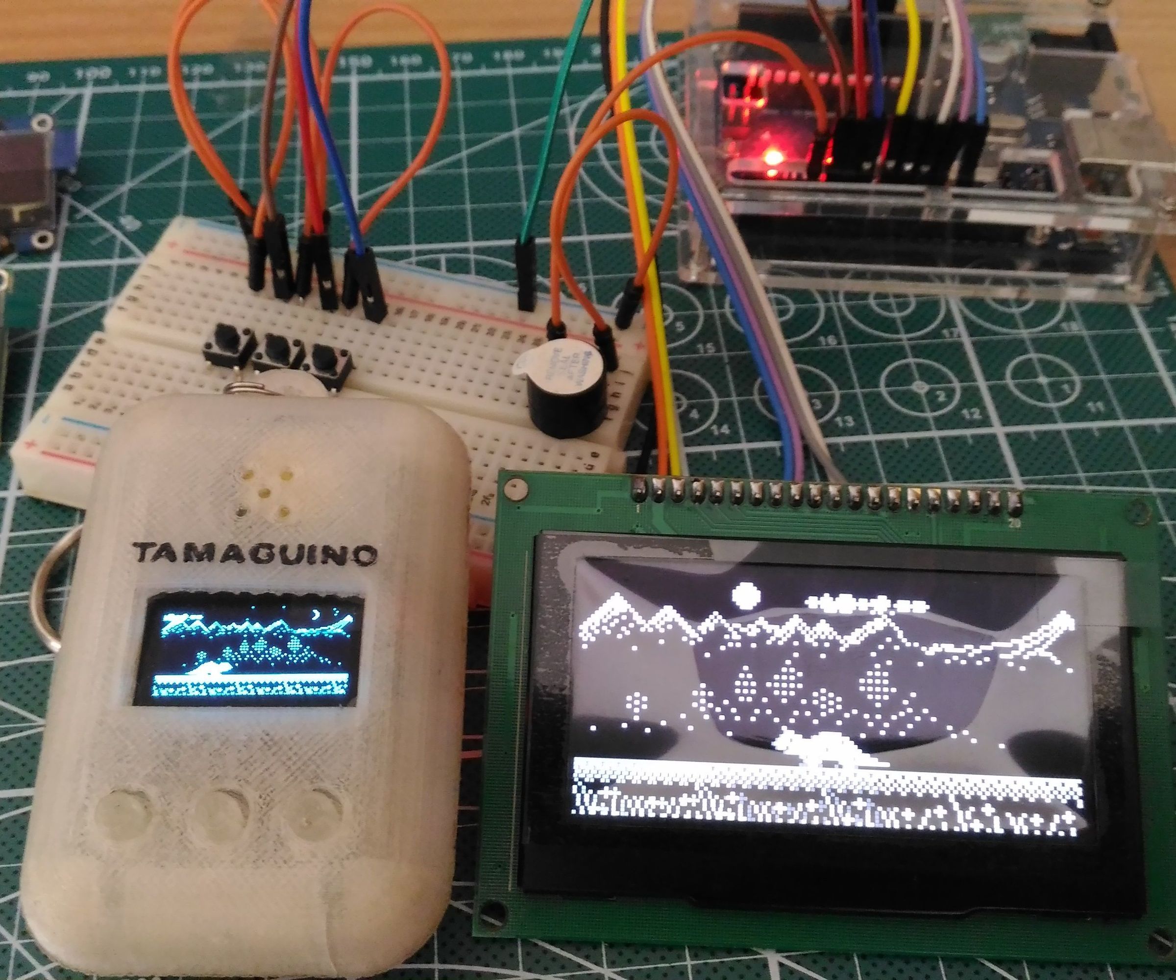

Tamaguino :)
Step 5: Make Your Own Games!
You are free to make your own games or port Arduboy and similar games to your handheld!
