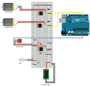

Step 3: Let's Build Something: Here's the Arduino Circuit.
So there are a couple of pieces to this circuit that are in play, so let me see if I can explain them.
First, in the bottom right of the circuit, we put a basic 9V barrel jack on our board. Be sure to get one that is compatible with a breadboard if you intend to use it that way!
Combined with that will be the 9V, 1.5A power supply that we used to power everything. This will provide all power to the 2 motors (the mixer and the liquid pump) as well as the LED that provides our light and the light sensor.
Moving up on the right just a hair, we've built a very rudimentary linear voltage regulator circuit. This provides +5V to the left side of the circuit ( the LED and sensor). There are quite a few diagrams online on how to set these up. If you aren't interested in doing this, just power the +5V items from the +5V on your Arduino. Just make sure that you are careful about separating the power into +9V for the pump/mixer motors and +5V for the LED/Sensor arrays. Note that I used a TO220 form factor 7805 (L7805CV) component and added a heat sink, since it can get hot enough to burn up without one.
The two circuit components at the top right are MOSFET circuits (IRF520). Using these we are able to rapidly switch the motor on/off and simulate reduced voltage conditions, using the PWM settings on the Arduino. We drove both of the motors from PWM ports (5,6 in our case).
To the middle left, we setup the light sensor(LX1972). Be sure to give yourself long leads on both the light sensor and LED, because you will be moving these around to find that sweet where the LED gives maximum illumination. This will be read from an analog input on the Arduino (A0 in our design).
Finally, the LED is setup on the bottom right of the diagram. It is simply an always on design.
Words of Caution:
Analog components can be tricky. 1) Be sure you know what lead needs to be positive and what lead needs to be connected to ground. 2) Most of the LEDs we used were optimized for 3.6V, hence the 220 Ohm resistor. The sensor needed a 10K resistor to cleanup the signal a bit. Don't run analog components without adding the correct resistor. They're not expensive, but it can be a bit disheartening to have to replace burned up LEDs and sensors.

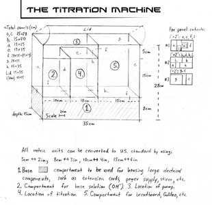

Step 6: Housing Considerations
You can see from the above images that we attempted to keep the acids and bases segregated from the electronics, and attempted to provide enough room to work with our hands. Frankly, we probably should have either built it bigger or cut an access panel in the right side to help us work with the electronics, since that was the hardest part to connect up for testing.
In the final design, the light sensor and LED were moved so that the light shined directly UP through the bottom of the beaker and was sensed above the acid/base solution. Just be sure to protect the sensor electronics from being splashed! That will short out your sensor.
