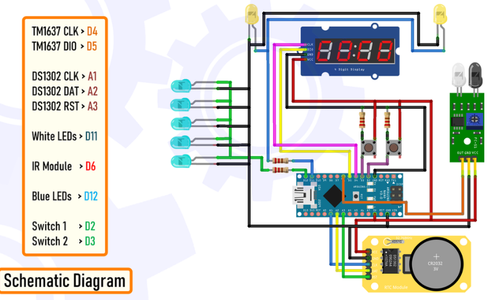

Step 3: Schematic Diagram
The Arduino's D4 and D5 pins are used to connect the TM1637 Digital Clock Module.
The A1, A2, and A3 pins on the Arduino are used to connect the DS1302 RTC Module.
The D11 pin of the Arduino is connected to the two White LEDs that are visible on either side of the digital clock. The minutes counter is reset to "00" when these two LEDs flash three times every hour.
The blue cluster of LEDs connected to the Arduino's D12 pin are controlled by the IR module, which is attached to the D6 pin.
To set the clock's time, my initial thought was to link 2 to 3 push buttons to the Arduino's D2 and D3 pins. However, I added an extra line of code to my application to do that in the final version. This will be fully explained when we talk about the code.

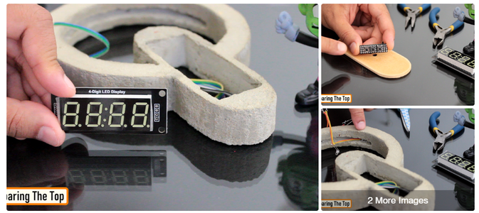

Step 5: Preparing the Top - Electronics
Okay, let's begin attaching the electronic parts to the clock's top section.
This opening will accommodate the 4-Digit LED clock module. I'll conceal it with a black plastic film that I tore out of some wrapping paper.
I'm using a compressed wood board for the back. I'm going to drill several holes in the board and add three push button switches based on my original design.
The gap at the back of the circular part will be hot-glued with the blue LED cluster.
The Blue LED clusters were covered with a milk bottle cutout made of plastic. It had a dismal appearance due to the white plastic, which was simply fantastic.

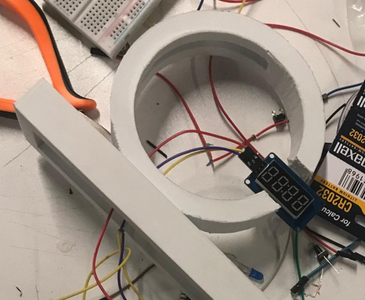

Step 6: Preparing the Base - Electronics
Okay, let's now assemble the remaining electronic parts within the clock's foundation. I made the baseplate using the same compressed wooden board, and then I soldered and hot-glued each electronic component to it individually. One of my own DIY IR modules was the IR module I utilized for this project. Please visit my Tutorial No. 21 - All About IR Modules and how to create your own DIY IR Module if you want to learn more about the module.

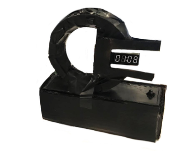

Step 8: Final Demo
So this is how it finally looks like.
