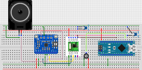

Step 6: Breadboard Circuit:
Here in this circuit LM386 is used to amplify the signal, to tune the frequency 100k potentiometer is needed. 10k potentiometer is for volume. If you use custom PCB then no need to do all of this. By the way, you may try this circuit on breadboard to develop your own ideas.
All the ceramic capacitors used in this circuit are 100nf, for resistors color code is given, all the electrolytic capacitor is 1000uf.
Lm386 amplifier does not support stereo channel, this is mono channel 3W ic.

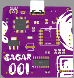

Step 9: Design of Custom PCB:
Download all the material regarding this project from here.
This PCB is designed in EasyEDA, I ordered this with purple solder mask. All the main components will be soldered front side and the speaker out terminals, tuning terminals, power and ICSP headers for programming is placed backside of this board.

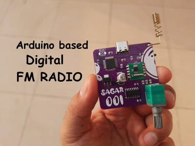

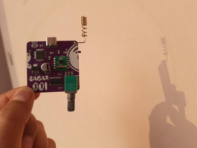

Step 11: Working of Circuit:
The custom PCB has PAM8403 audio amplifier, which is a stereo amplifier and has 3+3watts output. Microcontroller atmega328p has a 16Mhz smd crystal rasonator. RDA5807 Fm and other small controlling circuitry which you can see in the circuit schematics given above. Here I am using PAM class D audio amplifier because it is low power, dual channel and 5v supported. A 50k stereo potentiometer to set the volume level.
there is no any type of programmer IC on board but ICSP is provided for programming directly using Arduino or any other MCU. C-type usb jack is only to power the FM. To tune the FM to different channels, a 100k potentiometer can be soldered on 3-pins of tune section. Which gives ability to set any channel manually.
A small slide switch is only to switch on and off the whole system. If you want to try this thing first on breadboard using simple breakout modules then go for it, circuit diagram for breadboard is given above. Testing and other instructions are provided in video.
