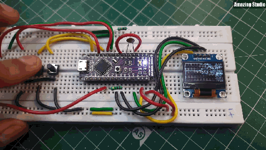

  • Arduino Nano
  • 1M resistors
  • 10k resistors
  • 1.3 inch OLED display
  • 100nF capacitors
  • 4 tactile buttons
  • 5v power supply

This project is only for educational purposes and shows the capabilities of a 16Mhz 8-bit microcontroller board. This MCU Can support frequencies below 50KHz, so it can’t be applicable for commercial and professional uses. That way, the project can also be entitled POOR MAN OSCILLOSCOPE for me. Also I found this helpful in project related to audio frequency below.
Step 4: Display:
1.3 -inch OLED display with I2C function comes with two different models, SSD1306 and SH1106, to change the code as per requirements. We have to uncomment which version of LCD we are using in this project. And the screen is able to represent the nature of the wave with duty cycle and frequency in two channels.

Pin usage
A0 oscilloscope probe ch1
A1 oscilloscope probe ch2
A4 I2C SDA
A5 I2C SCL
D3 PWM output for trigger level
D4 Up button
D6 trigger level input
D8 Down button
D9 Right button
D10 Pulse generator output
D11 PWM DDS output
D12 Left button
This small oscilloscope can be powered using 5volts @200mA. You can see two different circuits above, both are fine but one made by me is simplified and most useable in all cases. you can modify the circuit as per own.
Just have a look on those pretty waves in the oscilloscope.

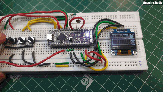

Step 8: Exploring the Menu:
Full menu has more options than the previous arduscope project. Yet, I don't get the big screen. May be next time I will built one using TFT and mega2560 board.
Step 9: Channel Switching Option:
Turn the second channel off when not in use because this will increase the sampling rate too.

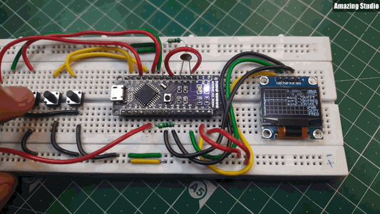

Step 10: Voltage Readings:
Also will also display the max and min value of the signal which is known as amplitude.
Step 11: Volt/Div and Time/Div

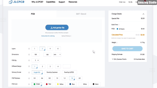

Step 13: Pcb Files:
All thanks to JLCPCB and EasyEda to Sponsor and generate such a good quality PCB prototypes. ordering process is also quite simple and shown above.
Download my Gerber files, Go to JLCPCB then select the thickness color parameters and order 5pcb's in just $2.
