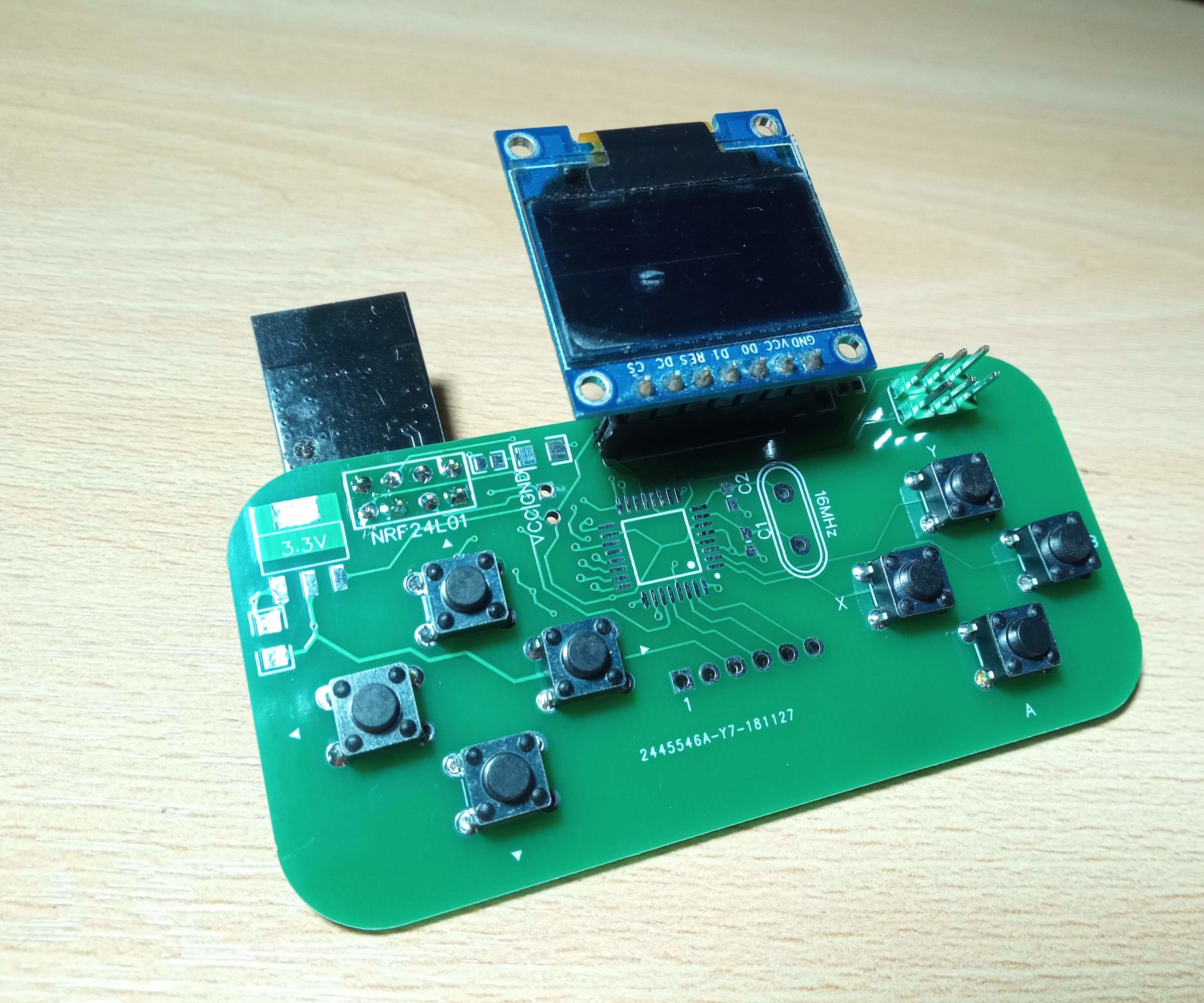

Step 1: Hardware
First step is to build the hardware. This design is really simple. All you need is an Arduino, screen and 9 buttons. Here's the list of all parts:
  • prototyping PCB (with dotted copper)
  • Arduino Nano
  • SSD1306 OLED-screen with SPI-interface
  • 9 pcs of 6x6x6 mm buttons
  • Female headers if you want to reuse the Arduino and OLED
  • Wires to connect the pins
  • Soldering stuff for soldering (obviously)
  • Rechargeable battery (If you want, it isn't necessary. I recommend using JST XH 2.5-2 pin connector for the battery. Also you might want to use the TP4056 charging and protection circuit.
How to connect the pins:
Connect the buttons like this:
  • Up = A4
  • Left = D3
  • Down = D5
  • Right = D4
  • X = A2
  • Y = A3
  • B = A0
  • A = A1
  • Q = D2
Connect the OLED like this
  • GND -> GND
  • VCC -> 3,3 V
  • D0 -> D13 (clock)
  • D1 -> D11 (data)
  • RES -> D8
  • DC -> D6
  • CS -> D7
