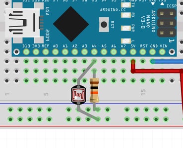

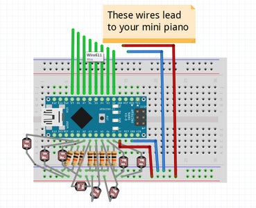

These Fritzning images show where all the parts plug into each other.
It gets a little crowded so I've added a second detail image showing the placement of a photocell and a 10k resistor connecting to a single analog pin. Repeat this pattern for each musical note on your piano circuit board.

Plug the Arduino Nano into the breadboard, bridging the gap along the center. Leave room on either side to allow for additional components.
Plug the 10k resistors into each Analog In/Out pin row and into the - power column. You can cut the legs off to make installation easier. Each analog in/out row gets one resistor each, for every note that your piano has.
(careful when cutting the legs off, the can fly off and cause all sorts of problems, wear safety glasses or hold onto the leg when you’re cutting it off.)
Plug the photocells into each Analog In/Out pin row and into the + power column.
Plug a breadboard wire into the 5V pin row and the + power column.
Plug a breadboard wire into the GND pin row and the - power column.
Solder wires onto each electrical contact for each piano key on your PCB that came with your mini piano.
Plug the other end of the soldered wire from the mini piano into a Digital In/Out row, one wire for each pin.
