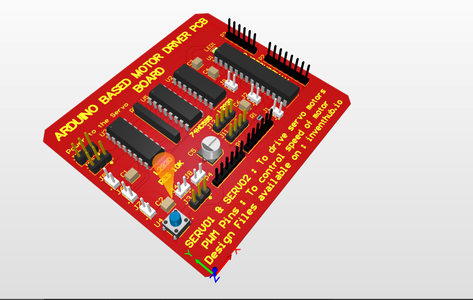

In this PCB module, you do not need to attach a separate Arduino to drive the motor. The MCU, motor driver and the supporting circuit to drive the robotic car are attached on one board. With this board, you can drive 4 DC, 1 Stepper, and 2 Servo motors at a time. Attach the car, code MCU according to your requirement, and enjoy driving your robotic car using a single board!

This Arduino motor driver board can work on both 12V or 5V power supplies. It has 2 L293D Motor driver ICs, 1 Shift register IC, and an ATMEGA328P MCU. Following are the major components with their explanation:

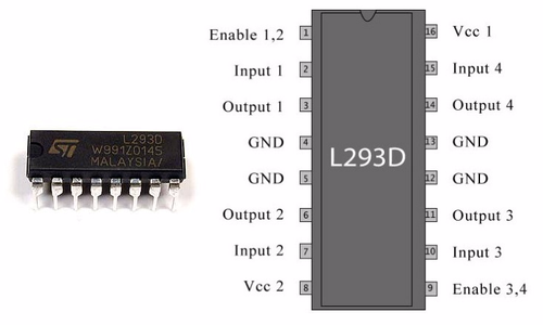

- L293D Motor Driver
It is a motor driver IC used to drive the motors in multiple directions efficiently. It has 16 pins that can control 2 DC motors simultaneously. It can control both small and big motors. The working principle of L293D IC is based on H-bridge. H-bridge allows the voltages to flow in either direction. The voltage needs to change its direction for being able to rotate the motor in a clockwise or anticlockwise direction. Inside the L293D IC, there are two H-bridge circuits that help the driver two control two motors at a time. It can provide a maximum current of 600mA per channel. The maximum voltage ranges from 5V up to 36V.

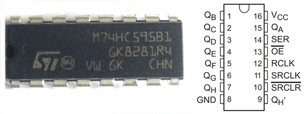

- 74HC595 Shift Register
It is an 8 bit Serial in parallel-out shift register used in communication with the microcontroller. It can receive data serially. It can be used to control 5V loads through a 3.3V microcontroller. It has a range of operating voltages from 2V to 6V. It has 3 pins connected with the MCU data, latch, and clock pin to communicate with the MCU.

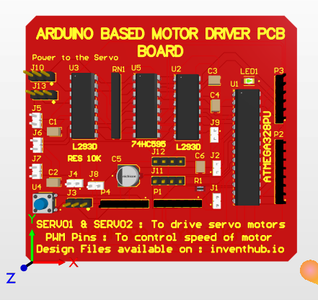

Step 2: Schematic
I have implemented the design on Altium Designer. After designing the symbols and footprints of the circuit on the schematic and PCB library, I have created the schematic design on a schematic sheet.
I have uploaded the schematic file online on Inventhub from where the user and manufacturers can download my design files and implement my design.
Step 3: PCB
For the fabrication, I converted my design from the schematic file to the PCB file. In the PCB file, I can make connections, route them, write the specifications of my board, and can view the 3D view of my PCB board. Then I uploaded all the PCB designing files online on Inventhub, the benefit of doing this is that mow I do not need to visit my manufacturer, I can send this PCB file to him so that he can fabricate my PCB.
