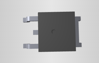

Voltage Regulator:
A voltage regulator regulates voltage during power fluctuations and variations in loads. It can regulate AC as well as DC voltages. It is a 1A, 10V, low-dropout voltage regulator. Dropout voltage is the input-to-output differential voltage at which the circuit ceases to regulate against further reductions in input voltage; this point occurs when the input voltage approaches the output voltage.

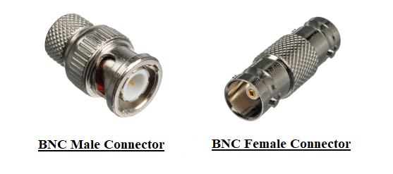

BNC Connector:
The BNC connector is a miniature quick connect or disconnect radio frequency connector used for coaxial cable. It is used to connect a computer to a coaxial cable in a 10BASE-2 Ethernet network. 10BASE-2 is a 10 MHz baseband network on a cable extending up to 185 meters - the 2 is a rounding up to 200 meters - without a repeater cable.

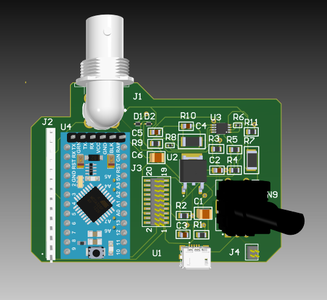

Step 2: Schematic
It is a 0-40MHz amateur radio antenna analyzer. A pocket device that measures the parameters of the antenna easily. We can add LCD to display graphically the results of the analysis.
I have used the Altium designer to design my schematic diagram. I have uploaded my schematic file online on Inventhub for the users who want to implement my design. They can go to the provided link and can view or download my design easily. I can also view the changes I have made in my design by going to the ‘view changes’ tab. I can also collaborate with the people, they can comment on my design and can give suggestions to improve my design further.

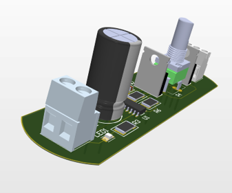

Step 3: PCB Design
I have converted my schematic file to the PCB file in Altium, where I can create connections on the board, define the shape of the board, arrange the components on the board, and can view my PCB in 3D view. I have uploaded my PCB file on Inventhub, where I can view my boards in different layers and can focus on a specific layer by disabling the other layers. Users and manufacturers can easily view or download my design for the implementation.
Step 4: Release File
I have created a release file of the project on Inventhub which contains all the design files in a ZIP file format. For the fabrication, I do not need to visit the manufacturer instead I can send him the release file of the project. He can easily download the files and can fabricate my PCB board.
