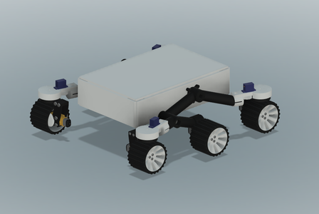

Introduction: Arduino Based Perserverance Rover Model (Fusion 360)
With NASA's Perserverance Rover recently landing on mars, I had decided to make a functional model of it using cheap parts and 3d printed parts that anyone can make
I have future plans to make it remote controlled using a bluetooth module and a robotic arm attachement like the real Perserverance rover

Step 2: Install Screw Nuts
A lot of the parts contain slots to fit in the Screw Nuts. However depending on your preferences, you might want to glue the parts instead.
Step 3: Assemble Corner Wheel Drives
- Install Yellwo DC Motor:
- Attach the yellow dc motor inside the Wheel_Main_Body_Corner 3d printed part.
- You can use the screw holes (drill to widen hole if nececary) or glue the part directly as I did.
- Install Bearing:
- Press fit a skateboard bearing on the little nub.
- If loose or for preference, you can glue the bearing directly on.
- Add Miter Gear:
- Press fit a Wheel_Main_DriveMiterGear on the motor on the side with the bigger hole.
- Install Bearing And Screw Nut On Wheel_Main_SteerGear:
- Press the nut inside the socket (use glue if necessary).
- Press fit the skateboard bearing in its socket.
- Install Wheel_Main_SteerGear:
- attach the Wheel_Main_SteerGear on the Wheel_Main_Body_Corner using 2 6-32 machine screws and screw nuts thru the 2 holes.
- make sure that the gear is oriented so that the gear is on top of the motor.
Repeat this step 3 more times for each of the Wheel_Main_Body_Corner parts to have a total of 4 corner wheel drives.

Step 10: Add Corner Wheel Drives
- In order to properly align the wheel drives, you must connect one servo motors and program them to be in the 90 angle.
- To do so, connect the servo to an arduino (I used an arduino uno)
- the brown wire of the SG90 to the gnd pin of the arduino
- the red wire to the +5v pin of the arduino
- the orange wire to the 6 pin of the arduino
- Run the following code on the arduino
#include <Servo.h>
Servo servo;
void setup() {
servo.attach(6);
servo.write(90);
void loop() {
3. Fit Wheel_Main_SteerGear in the Wheel_Steer_Body (with the servo activated) so that the tires are parallel to the
tire of the middle wheel drive (make sure to orient it according to the images)
4. Drive a screw thru the joint to secure the Wheel_Main_SteerGear to the Wheel_Steer_Body
a. Make sure not to do it too tightly
Repeat this step on for the other servo body
