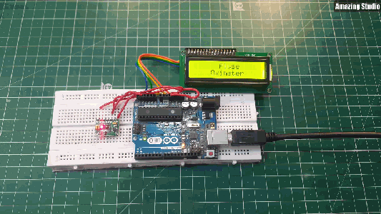

Step 6: Circuit Diagram:
Both the LCD and sensor use I2C communications, so we can connect both of them to same A5 (SCL) and A4 (SDA) pin. Arduino uno i2c have 7 bit addresses so we can use 127 devices in parallel. To power up the sensor and lcd we can give +5v. And rest of the work is done by the microcontroller itself. Download Circuit diagram, code and Gerber files from here.

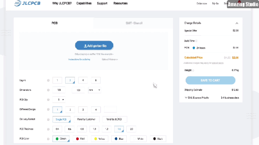

Step 7: PCB Designs:
I want to minimize this DIY design, so here in the PCB I am using Arduino Nano MCU, 16*2 LCD, MAX30100 with charging circuit.
This is tested schematics, but the LCD only work on I2C port. Pins are just for understanding purpose. If you want to use same design as mine then Download the Gerber files from here. JLCPCB offering a very good service (just $2 for 5 Pcs).
And if you Sign-up using my link, you will get reward coupons of worth $27 and some SMT assembly/ PCB prototype coupons on each successful order.

Step 9: Measurements:
With health monitoring this code also have some symbolic representation on screen which is with smile face, rough and normal face (emoji).
Step 10: Measuring:
Measuring BPM and oxygen level is too simple, just place your finder gently on the Max30100 sensor. It will automatically start the system. You will get a full accurate reading after 10 seconds and its done.
You can also use prototype PCB Gerber file to make this project more practical, with inbuild power supply and a compact size. By the way, A big thanks to JLCPCB to sponsor this project.
