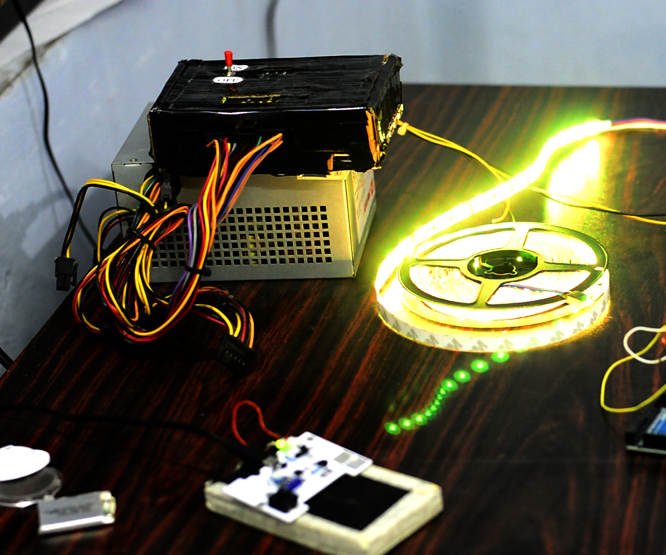

So after testing the code it is time to move whole test set-up to permanent board. I have used FQP50N06 N-channel MOSFET to amplify the PWM signal from Arduino pin 3.
I used female header to mount Arduino to the perfboard so that I can remove the Arduino if anything goes bad in future.
I don’t trust sensor because this is second time I am building this project, so I am re using same sensor for 3 times. So I am using female headers to mount the sensor, so that it can be replaced any time. It can also be helpful to extend the sensor in case I need any adjustments.
Digital pins of Arduino can only handle 40mA and I don’t have any transistor that can handle 500 mA current draw for group of LED’s, so I decided to use an N-channel MOSFET to amplify the PWM signal from Arduino pin 3.
If the LED’s are below 40mA they can be directly connected to digital pin of Arduino by adding 220ohms resistor.
I designed the layout in fritzing and followed the schematics to solder on to a perfboard.
For portability purpose I am planning to use 9v battery to power the device by connecting to raw pin of Arduino but I am concerned that those high power LED's can drain battery quickly. So first I will use this device with battery and mark the battery life if it is reasonable I will continue to use on battery otherwise I will switch to a wall adapter of around 9 volts. So I also have added two male jumper pins to board to connect positive and negative wires form power supply.
I also added a red led with 220ohm resistor to indicate the activity of arduino, next key press can be accepted after led is off.
This project can be rebuilt for any setup by simply modifying codes and if condition in the Arduino code.
