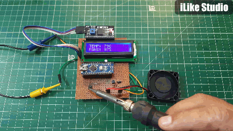

Step 5: Observations:
These are some observations I got, at room temperature:
On heating
On cooling
Using the same idea of reading temperature, we can program Arduino to generate a PWM signal. Which then trigger the switching transistor and hence control the fan and fan speed.

Step 9: Working:
The temperature controller is working quite fine. As I make the contact of lm35 with heated solder Iron the fan speed is increased to 90% and temperature can be seen respectively to it. Don't forget to claim coupons of $54 from JLCPCB.
