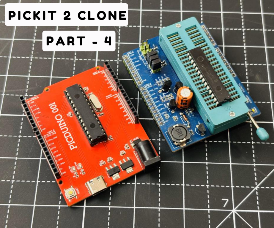

If you want to make your own Arduino, like mine one. All the Gerber files with circuit details are here for you. PCBway is the only prototype PCB company offering a great PCB boards in lower prices and If you sign-up using this link you will get newcomer and sign-up coupon rewards.
