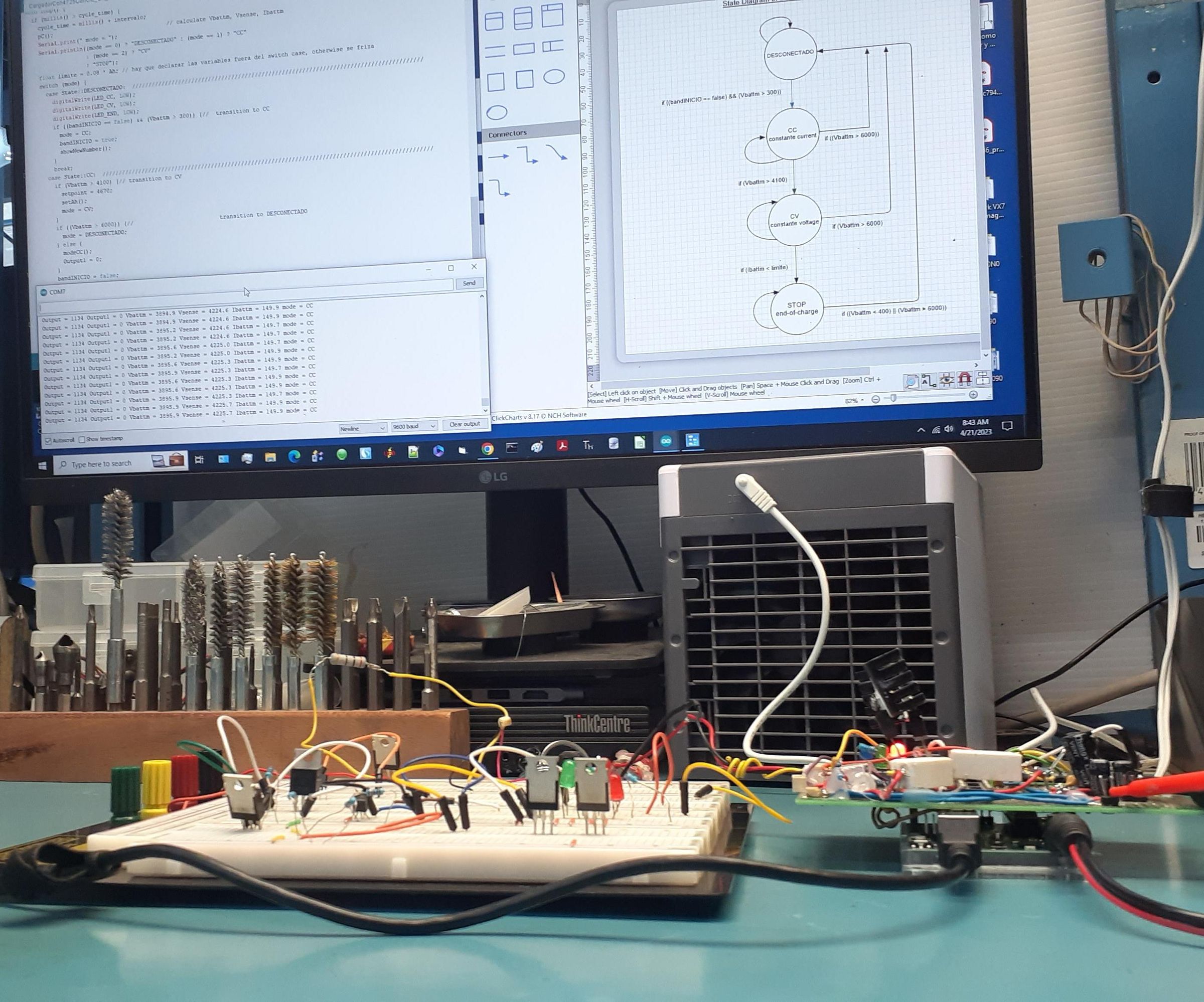

The circuit is a current source that draws 0.2C (in this case 4mA) and 2C (in this case 40mA) from batteries using only one circuit controlled with the PWM signal from Arduino. This way it is possible to measure all backup batteries with C = 20mAh, regardless their voltage in the range from 1.2V to 4.8V and other batteries with a different capacity too. In the first version, I used two transistors each with a load to drain 4mA and the other 40mA. That variant was not appropriate for the future since they wanted to measure other batteries with different capacities and this scheme required a large number of resistors and transistors.
The circuit with a current source is shown in Fig. 3. The frequency of PWM signal from pin 5 of Arduino board is 940Hz, that’s why, the Fc of Low Pass Filter (LPF) is 8 Hz, it means that the first harmonic of PWM signal (940Hz) will be attenuated 20dB because the RC filters provide 10 dB of attenuation per decade (every 10 times the Fc – attenuation will be 10dB in 80Hz and 20dB in 800Hz). The IRFZ44n transistor is oversized because, in the future, larger capacity batteries will be tested. The LM58n, dual operational amplifier (OA), is the interface between the Arduino board and the IRFZ44n. The LPF was inserted between the 2 operational amplifiers to ensure a good decoupling between the microprocessor and the filter. In the Fig.3, pin A1 of Arduino is connected to the source of transistor IRFZ44n to check the current drawn from battery.
The circuit is composed of 2 parts, below the Arduino UNO board and above the current source, as shown in the next photo. As you can see, in this circuit there are neither switches nor buttons, they are in the UI in pc.
This circuit also allows measuring the battery capacity in mAh since it has a current source and the Arduino board has a timer.
