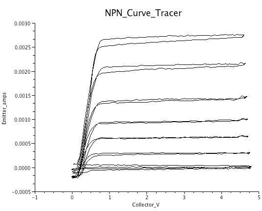

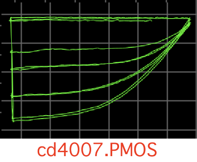

After compiling and uploading the Arduino code. Hitting the run button will bring up a graph window. Clip that window and type "s" to start the curve tracing. Typing "w" will write the data into your computer. Use the Show_Sketch_folder menu to find the data file. It will be labeled with the exact second the curve tracing started. This is a good time to rename that data file.
Step 5: Plot the Curves
Programs like SciLab and Octave can read and plot the data file, provided those programs know where to look for the file. The file path can usually be found by opening up a unix terminal window and dragging the file into it. There are four templates. One for each type of transistor. Both the Scilab and Octave templates are included in the previous text file and previous pdf file.
