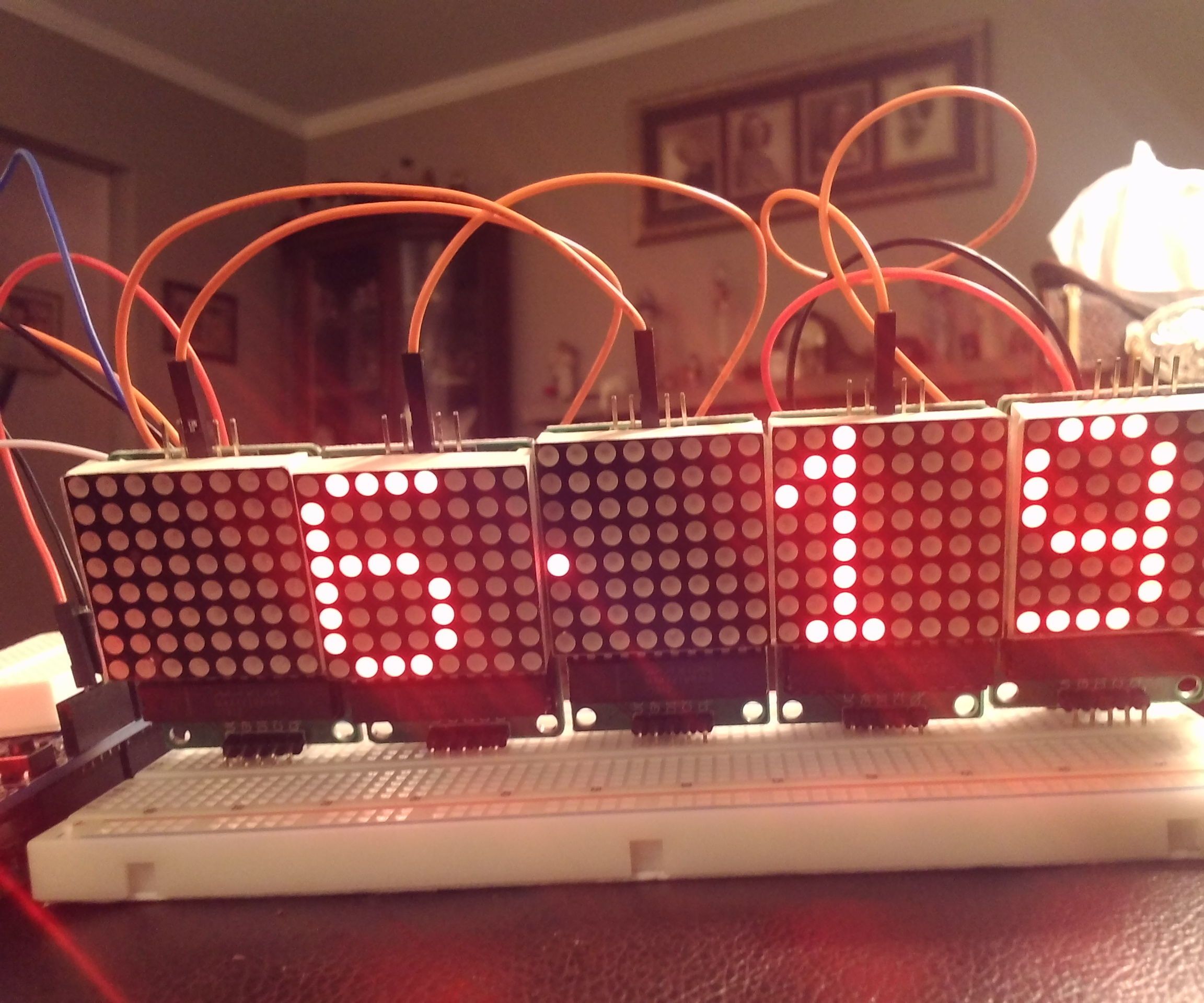

After building in and seeing it in action, I find the display disappointingly petite, a function, of course, of the LED matrix size.
