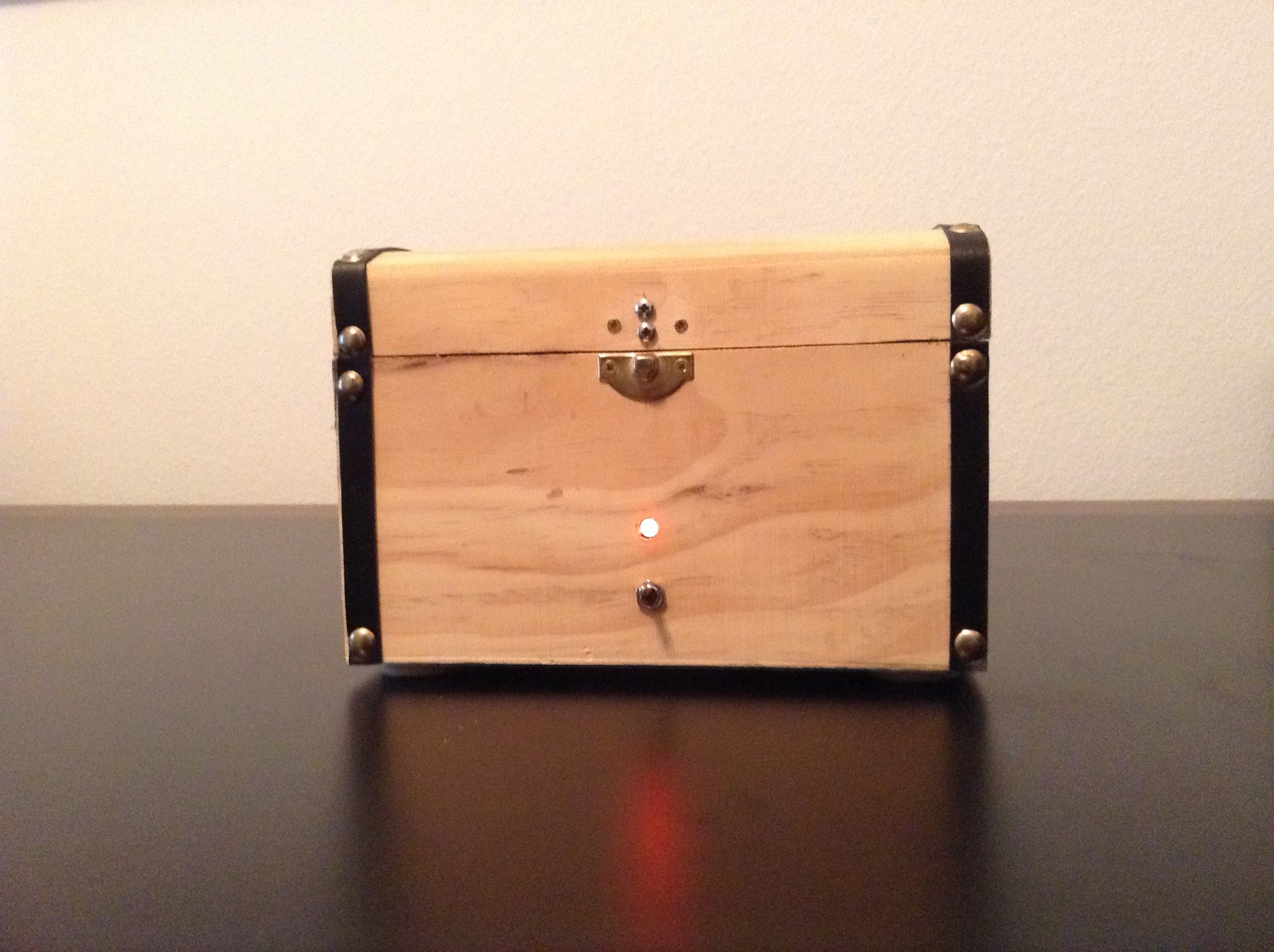

(Note: You will see in the photos that I made the Master box before finding the hinged box for the Slave at JoAnn. I strongly recommend this box. It is almost the same size, well-made, reasonably priced, and the hinged lid is great, compared to removing and replacing screws, when needing to access the inside. I actually paid more for the Master's ¼ inch JoAnn plywood, that I already had on hand, and wasted time and energy making it. So, I will assume that you will use two of the JoAnn boxes.)
Remove the hinged tops and hinges. Put the hinges and screws in a safe container to avoid losing them.
The displays and keypad mount under the box tops with the obvious parts poking through. Carefully measure those parts to determine the dimensions for the required rectangular holes in the tops, aiming for a neat close fit. A caliper is best for this purpose.
Lay out these outlines on the box tops with pencil and ruler, centering them horizontally and spacing them vertically as desired. Also, remember to locate the LED on the Slave top. I placed (Blue) masking tape on the penciled lines to make a very good guide for cutting.
Drill a hole for the saw blade and proceed to cut as close to the tape as you can without straying over the line. Finish the holes by filing or sanding down to the tape/line. Then test the fit with a display. If it's too tight, you may be able to force the fit in the relatively soft basswood.
Now lay out the center holes for the switch, jack, and LED, marking them with an ice pick (or center punch). Determine hole diameter by test fitting the parts in the drill bit guide. Then drill the holes.
Now is a good time to seal and paint the box exteriors. Basswood absorbs paint, so brush-seal before painting. After drying i sprayed the box bottoms and tops with Rustoleum gloss blue, only doing the outside. I did elect to mask all holes with masking tape on the inside.
When dry, put the hinged box tops back on.
A latch is needed for the hinged top and it needs to be internal In order to enable the Slave to sit upright. I fashioned a simple latch that works well. Cut a plastic business card to the desired shape and glue it to the inside of the box top, centered as shown in the Step 6 open-box photos. Drill a pilot hole and a countersink hole in the box bottom front for a small screw that will engage the plastic. Measure screw center distance down from the top edge of box bottom, transfer it to the plastic, and use the ice pick to punch a hole, centered on the plastic, that will pass the screw. Screw in the screw and the box will be latched. To open, use a thin knife blade to push the plastic off the screw. To close you can actually use your finger, or again use the knife.
