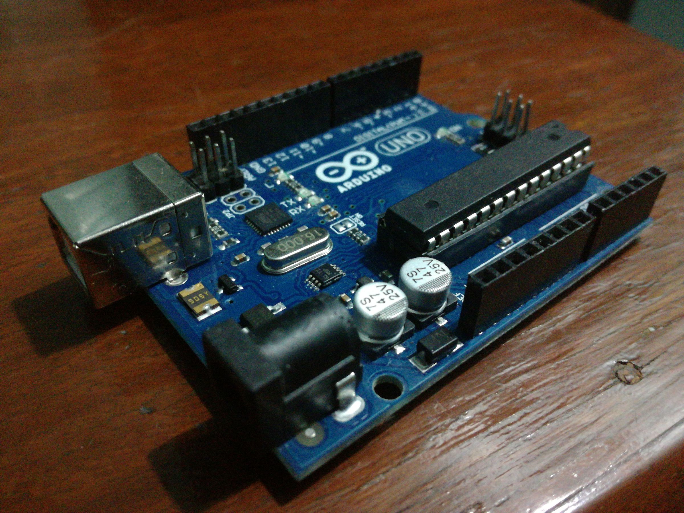

- Arduino Uno
- Geared motors
- Bluetooth (HC-05)
- Motor driver (I made mine using L293d, but you can use L298 motor driver module)
