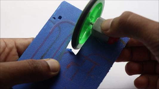

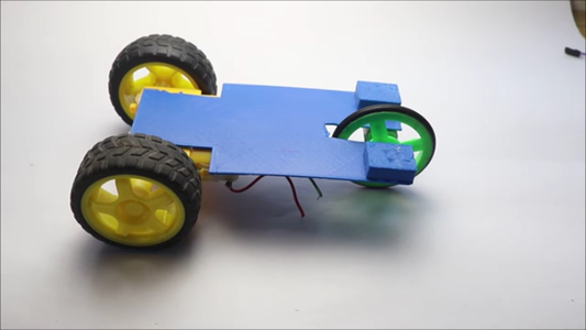

Step 2: Frame and Wheels

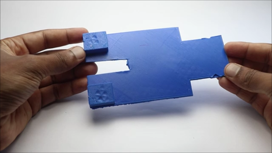

You might think from where did i get that frame from, I got it from my previous project where i 3d printed it for this frame part.
There is no rule to use the exact same design, You can use alternate materials like cardboard or readily available plastic frame for this purpose, But i would suggest to build this as per your needs.

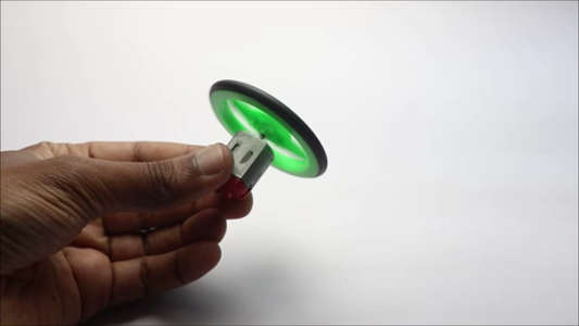

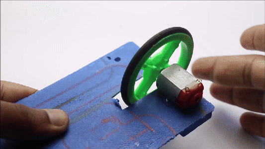

I will use 3 wheel type you can also use 4 wheel if you feel struck in the design part for 3 type.

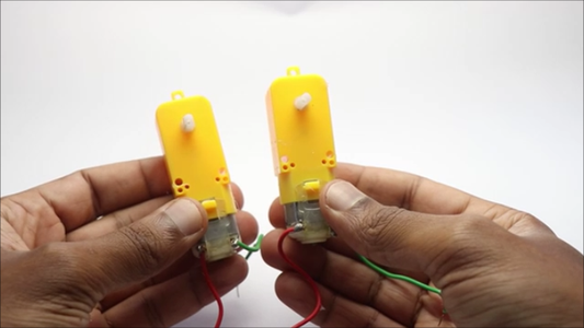

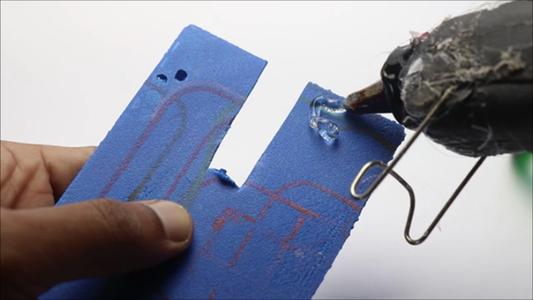

Use good amount of hot glue to attach servos to the base of the frame and allow to dry completely, I will use a toy dc motor to its shaft i have connected a wheel and you can see how smoothly it will rotate.

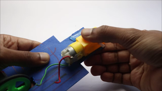

Now do the same for bo motor, My frame was optimised to use the component space so everything fits well and no extra space is wasted thereby making the project small.
After the bo motors are glued we can connect the wheels, Most of the wheel types are press fit and there is no need to use any additional coupling materials here.
Now we have the frame ready and head over to installing the electronics part onto this.

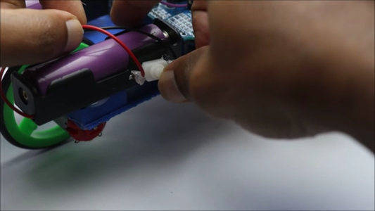

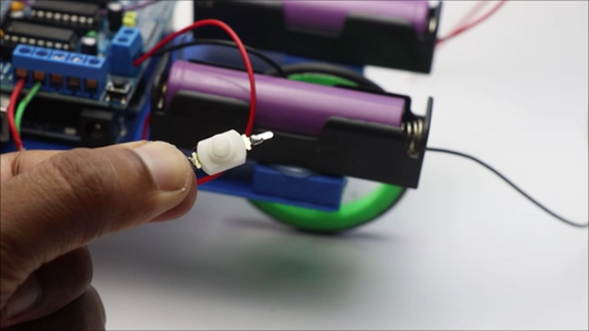

I will glue the 2 battery holders on the little hump part(balancing) and in the end connected batteries onto this.
For the proper power supply when required i will use a small on/off switch, Glue it to the side of battery frame.

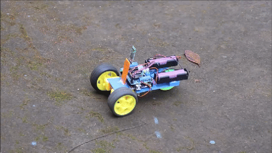

If this is complete we are almost at the last part of this build phase and now you can see how we can use this project, Take your phone and follow the below said steps to make this robot work
Step 4: How to Use
Using this is very simple, You can turn on the switch and now you will see the bluetooth module light blinking.
Now open Bluetooth on your phone and connect for HC05 name and connect to that device, Open the Bluetooth controller car application on your phone.
There are many controller in the google play store and you can install any one as per your choice, Open the application and you may need to connect to the Bluetooth module again.
In the controller application you will find lots of option like front and back, left and right and in some you will also find light option(for this you should connect the LED to uno board separately)
In all the application you will find a detailed guide on how to connect and use the application, If you feel struck anywhere you can check all this or if you think everything is fine you can simply continue
