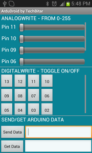

Step 3: App
Once connected all, open the application Ardudroid and connect the device (usually must be intetnar 2 times to get it)

If it is desired to control the power of a device, the signal will be connected to the pins 3, 5, 6, 9, 10 or 11
The current program that I uploaded, has an additional one, which is the temperature reading, is used with a lm35, the signal goes to port A0 and if you want to read, you must press pin 2, to write the current temperature in the application
