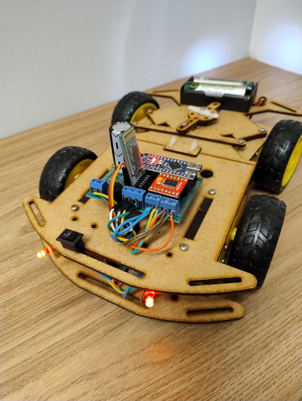

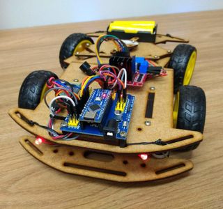

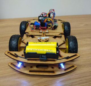

Introduction: Arduino Bluetooth 4WD Car With Steering
Bluetooth remote-controlled 4WD car using an Arduino Nano v3 board with steering performed by a servo motor

Step 1: Schematics
You can use either a L298N (easier to build) or a TB6612 Bridge (better energy efficiency)

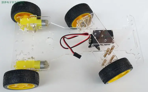

Step 2: About Car Chassis
This project was designed to have a servo motor steering the front wheels

Power Supply
I recommend to use high quality 18650 batteries (3.7v - 4.2v, 2200mAh, at least 2C of discharge rate).
Most people prefer to use different power sources for Arduino (5v) and Bridge driver (7.4 - 8.4v).
I prefer to have a single power source and thus a single power switch. However, it was required to use huge Electrolytic Capacitors (around 8,000 to 12,000µF) to prevent Arduino Nano from rebooting when the 04 DC motors drains too much power. The capacitor is also useful to filter some electric noise. Note: in the video recordings above, I used 2x 18650 batteries 2600mAh (3C) and one 10,000 µF capacitor.
It is up to you!
