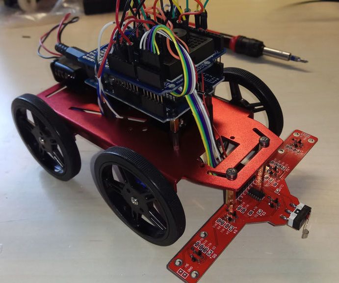

This is our new Bluetooth RC car - based on our favorite Arduino UNO! In this project as you can see we used a custom-made PCB board and the ATmega328p micro controller. The board is specially design for this project and for small RC models. You can simple control it from your Android phone or tablet via Bluetooth. From the Android application you can also turn on/off the front and rear lights and play a horn sound! For our RC model we used only 3x1.5V AA batteries!

Step 1: What You Will Need - Hardware
For this project you will need:
- Our custom PCB circuit (find it in next step)
- Atmega328 (with Arduino UNO bootloader)
- 28 pin dip socket & 2x 16 pin dip socket
- 2x L293 IC or SN754410
- 16 MHz crystal oscillator
- 10 uF capacitor
- 2x22 pF ceramic capacitors
- 10 kOhm resistor
- Buzzer
- Bluetooth module HC-06 (or HC-05)
- 4x screw terminal 2P 2.54mm
- Pin header 1x5 Female
- Pin header 1x40 Male
You will also need a TTL to USB module or an Arduino UNO board for the programming procedure.
