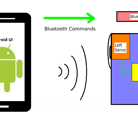

1) Connect BT gnd to gnd of arduino and 5v to 5v of arduino , connect tx pin of bluetooth module to rx pin, then connect rx pin of arduino to 2.2 k ohm resistor and connect the other end of resistor to 4.7 k ohm and connect the other end of 4.7 k ohm resistor to gnd and the rx of BT module should be connected to the middle of both 2.2 k ohm and 4.7 k ohm resistors.
2) Check the connections.
3) Now after setting everything install the application
4)go on to BT and select the device to connect
5) After device connected come to back section main menu where there are ON/OFF buttons. Now click on to the buttons for testing and congrats you made it working hurray!!
