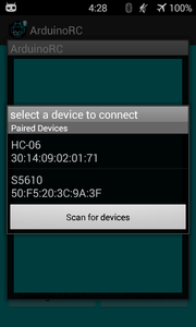

After all that, you need to connect your phone to the bluetooth module. Power the arduino(and at the same time the bluetooth module) and find it in. My was named HC-06, so you can search for semething like that.
Once you added the device, download this app for Android. I don't know if this works with Apple devices. Correct me in the comments.
the app: https://play.google.com/store/apps/details?id=eu.j... , so it's called Arduino RC

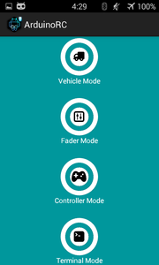

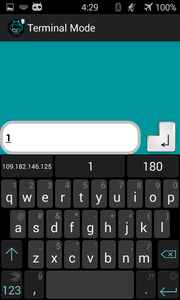

Once you downloaded the app, run it and click connect to device. Choose your bluetooth module(my is the first one) and you will be taken to "the lobby". If you have noticed, this app is for RC(remote controll) which is perfect for controllng a car or sth. It has buttons or gyro sensoring. But what makes it not only for RC is the "TERMINAL MODE". There you can type in anything that will be sent to the arduino. In our case, If you send 1, the LED will come on, or if you type 0, the LED will go off.
