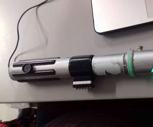

Step 9: Assemble the Lightsaber With the Components
First, we secure the accelerometer the original board of the saber was. The buzzer matched with a hole in the lightsaber, so we secured it there. Then we secured the bluetooth module with tape, on top of the accelerometer. We put the Arduino Nano using the foam it came packaged with. We paste it with glue. We secured the channel of the breadboard using hot glue. Finally, we secured the LEDs with tape and glue in the top of the saber.
