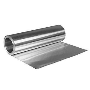

Aluminium foil

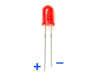

LED

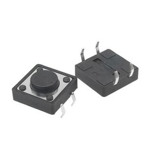

Buttons x2

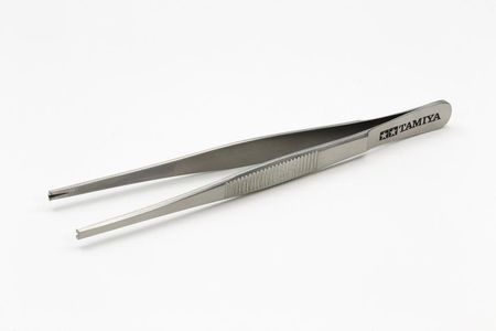

Tweezers (made of metal)

int ledPin = 13; // red led

Bottom : a cardboard coated with a aluminium foil with jumper wire connected with pin 2
(remember to the aluminium foil should be in one piece to make sure it can connect with electricity.)
I use glue and aluminium foil tape to stick on the cardboard and stick it with the jumper wire which connected to the ground.
Then I connect the tweezer to the jumper wire which connected to pin 2.
If the tweezer touch the aluminium foil, the circuit will be complete and the Arduino board will read a LOW.

The lcd monitor will be our scoreboard and it did't count mark automatically. Which means player should press the buttons in order to keep score.
P1 = green button
P2 = blue button
When user press the green button, the lcd will add 1 on the score of P1.
