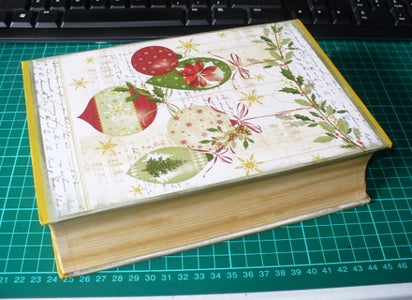

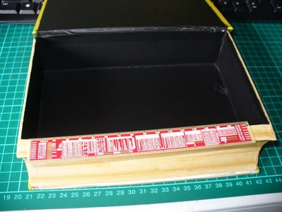

First, you’ll need a book of some sort, something large enough to hide the electronics yet not too large to look “suspicious” – then cut the guts out to make enough space for the electronics. Then again it’s subjective, so get whatever works for you. Coincidentally we found some “dummy books” (not books for dummies) that were perfect for the job, shown in the photo above.
After spraying the inside with matt black paint, the inside is better suited for the “eyes in the dark” effect required for the project. The “book” had a magnet and matching metal disk on the flap to aid with keep the cover shut, however this was removed as it will not allow for smooth opening with the servo.

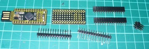

The electronics are quite simple if you have some Arduino or other development board experience. Not sure about Arduino? You can use any microcontroller that can control a servo and some LEDs. We’re using a Freetronics LeoStick as it’s really small yet offers a full Arduino Leonardo-compatible experience, and a matching Protostick to run the wires and power from.

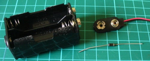

By fitting all the external wiring to the Protostick you can still use the main LeoStick for other projects if required. The power is from 4 x AA cells, with the voltage reduced with a 1n4004 diode.

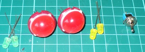

And for the “eyes” of our monster – you can always add more if it isn’t too crowded in the book. We’ll need a resistor as well for the LEDs. As LEDs are current driven you can connect two in series with a suitable dropping resistor which allows you to control both if required with one digital output pin.

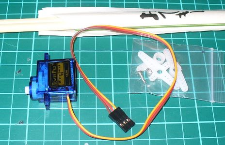

You can use the calculator here to help determine the right value for the resistor. Finally a servo is required to push the lid of the book up and down. We used an inexpensive micro servo that’s available for a few dollars from the typical outlets.

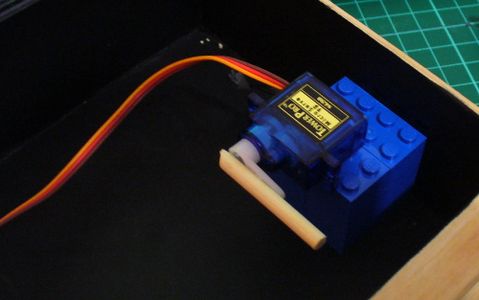

Finally a servo is required to push the lid of the book up and down. We used an inexpensive micro servo that’s available for a few dollars from the typical outlets.The chopsticks are cut down and used as an extension to the servo horn to give it more length.

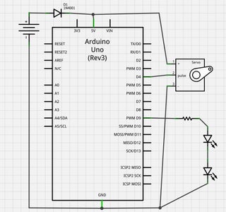

Don’t forget to paint the arm black so it doesn’t stand out when in use. We had a lazy attack and mounted the servo on some LEGO bricks held in with super glue, but it works. Finally, here is the circuit schematic for our final example – we also added a power switch after the battery pack.

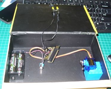

After some delicate soldering the whole lot fits neatly in the box as shown above.
